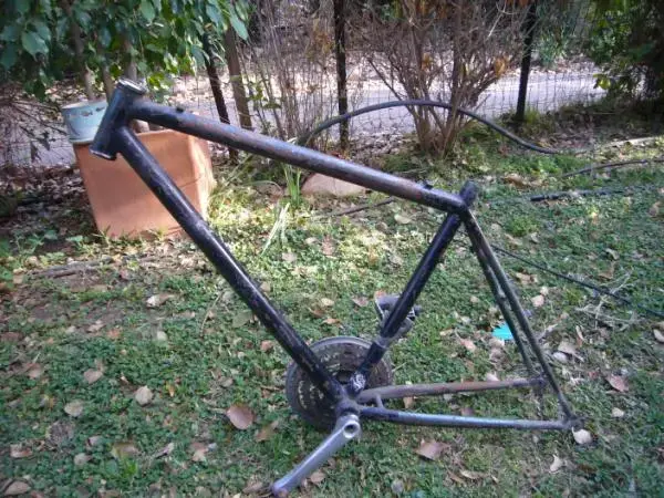

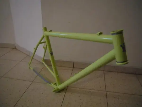

Thank you guys for the help with the old bike i found:
Here some pictures of it, before and after

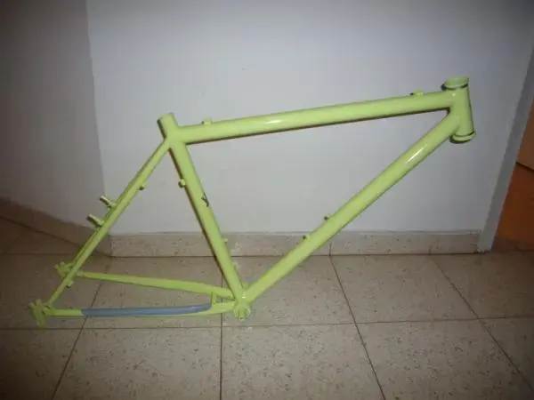

:shock: Well that makes life interesting I suppose :shock:
Other than that it looks quite nice!
no...
no headset (what you see is the graphical lines).
I left the BB in so the paint won't get in. this BB goes to the trash.
Re: you are wrong
jellob":1v177hjz said:
they are not.

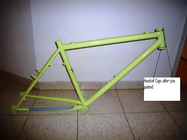

I am afraid you have see below for details on it we see the grey graphical lines on it but you have left the headset cups in frame and a shame aswell as its not a bad paint job hope it doesnt crack the paint to much when you take out the BB and Cups out, other than that nice colour i like it

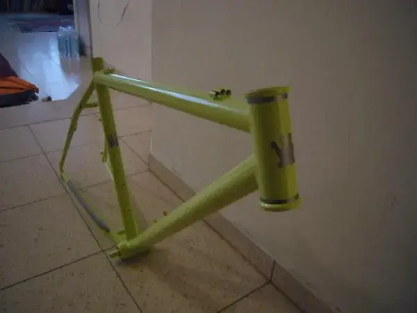

nice colour,looks clean.Hope the paint wont crack when you remove the old b/b.Also unless theyre masked off remember to give the brake pivots a rub down :wink:
Stanley knife around the joint between the cup and the headtube carefully so that when you do remove the cups you wont tear the paint. You may get away with it, repairing my mistakes is as much part of the job as the job itself !
