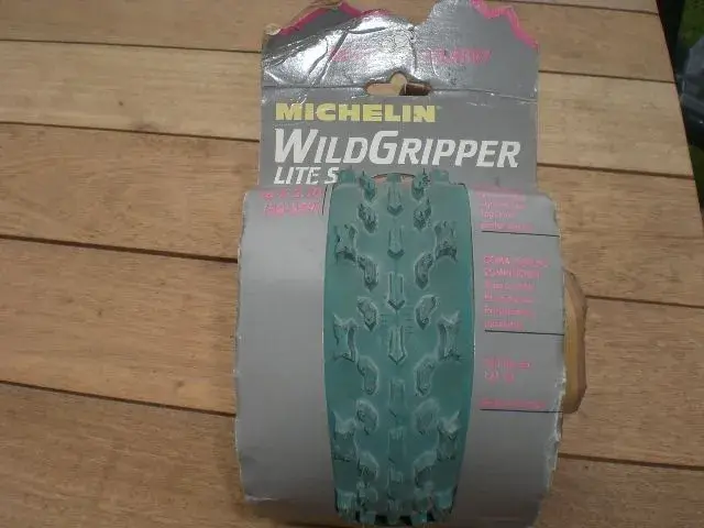

I even stumbled on some reto gold there which has fitted my Saracen plan perfectly!
so not such a bad trip to the LBS after all 8)
