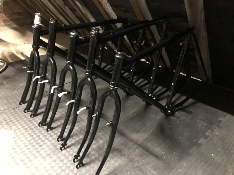

Not that it really matters but;
1987 20" 531 all terrain, XT Headset & tapered Cro-mo forks 3300g
1989 22" 531 all terrain, Tioga Headset & tapered Cro-mo forks 3870g
1990 20" 531 Magnum, DX headset & Cro-mo forks 3780g
1991 20" 531 Magnum, Tioga Headset & Cro-mo forks 3920g
1994 18" ??? Magnum, Tioga Ahead & Cro-mo forks 3670g

I wonder if the rear triangles are 531 or 653 at all or if only the main triangle has that tubing
Did the original decals give any clues?
"653 Magnum Tubes" as opposed to "653 Magnum tube set" so yes, as you suggest 653 for the main tubes and 531 for the rest might be the case...

They'll come in handy if the roof caves in: SOLID :D

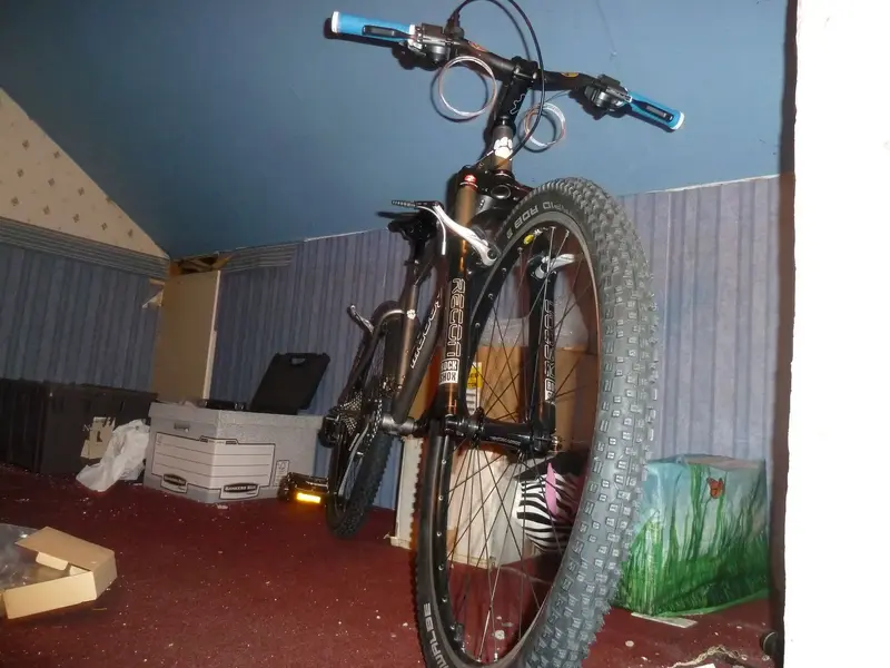

Glad I'm not the only one (although mine's actually a work space) :shock: :lol:

Or possibly generic cromo for the stays?
I've had a few frames with reynolds tubing that have seemed overly heavy. I came to the conclusion it was cost cutting - use the minimum amount of reynolds to allow a reynolds decal to be fitted.
Also had some reasonably light frames with boat anchor cost cutting forks
