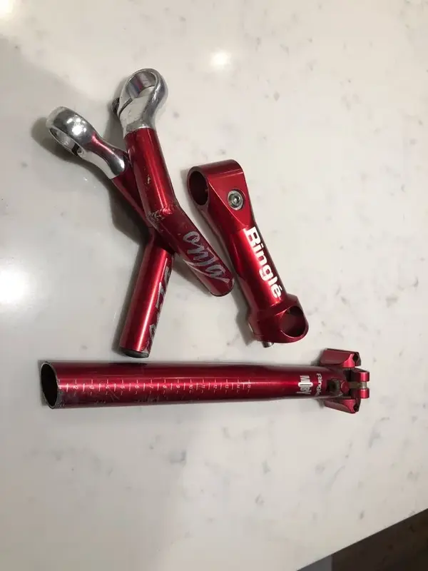

Hello,
My F5 came with a Ringle seatpost and Ringle ahead stem, and Pace RC130 flat bars.
And Onza L-bend bar ends.
All in red anodised!
Regards
Mat
