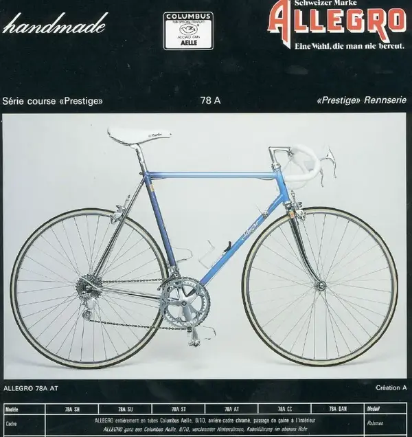

Sante was an option on all Swiss Allegro bikes of the period too. I had it on my old Prestige model. Lovely group set. It's the 78A ST. prestige.webp
