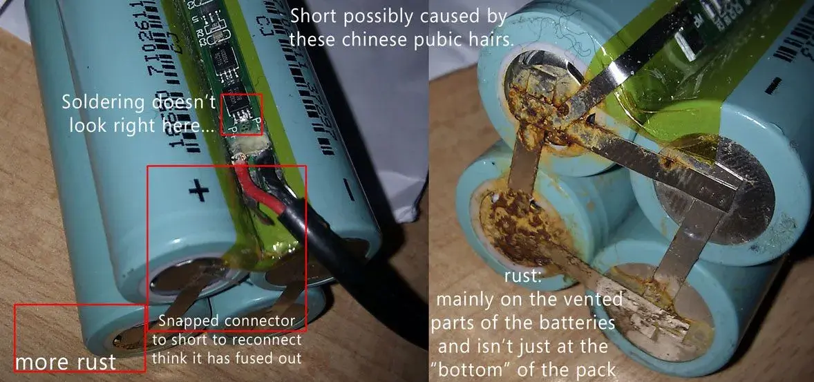

My battery is dead too, I took it apart to find a fair bit of rust - (Mine was wrapped in clingfilm all the time) the connecting strips and charging circuit seems to be to blame as the cells are fine.
One connecting strip has burnt out and reconnecting it gets nothing out of the battery via the circuit board, very disappointed but that is the risk with self-imported goods.

I'll try to take a look tonight and get a photo up if possible (I'm short for time, but I'll try). Are you able to get a photo of you damage?
Blimey. Defo gonna quickly take mine apart when I get in. That is freaking terrible! Incidently.. mine was also sealed against water incursion.
I've ordered another from that link above, I'm tempted to take it apart before I use it to see what it is like "new" They aren't waterproof anyway so new heatshrink and perhaps a home-made silicone case with prevent further issues.
I am gonna go out on a limb here and say that the problem is not caused by water. I reckon it's caused by badly chosen metals/solders and possibly even some chemical leakage aiding corrosion from the batteries themselves (although I don't know if lithium batteries tend to leak?)
I agree, I think is is a venting issue with the heat build up aiding corrosion.
I'm starting to think my totally sealled clingfilm method might have been part of the cause....
