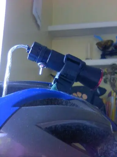

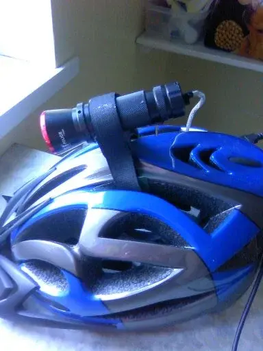

Ok.. been a while, but I've been faffing again.
I've removed the button mechanism entirely and put the power feed in through this opening, rather than through the bottom. I've used the hole in the bottom to mount a temporary switch. This switch is one I nicked off a non-working graphics card for it's variable speed fan, so in it's two position's it is "ON ON" rather than ON OFF. This mean's in the mode that the light isn't "ON" (no light), the cable starts to heat up. I'll rectify this later, as I'm still just playing around with stuff.
I do wish at this moment in time that I should not have bothered getting the expensive 'driver' circuitry, and just stuck with the basic circuit that's included in the original tail cap (with the button). I can't currently get it to do anything other than switch between high and low modes which is really annoying. I'm probably missing something stupidly obvious in my wiring.
Anyway.. here is what I have at the moment:
