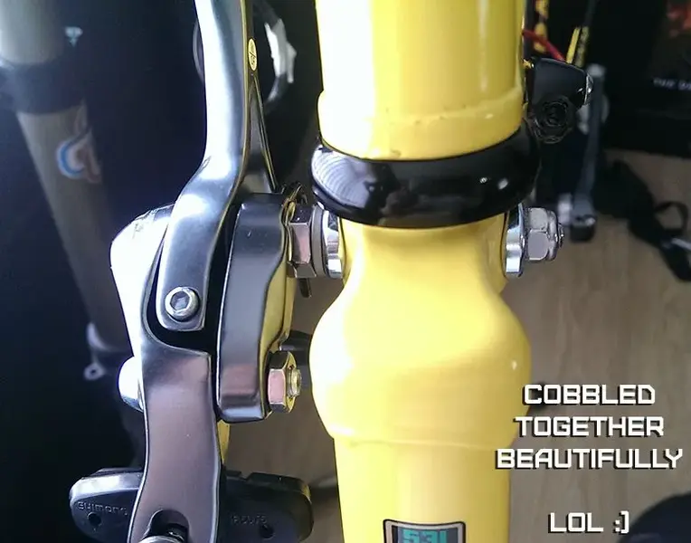

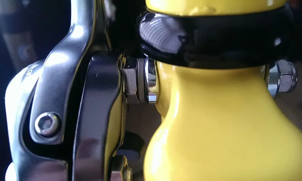

legrandefromage":3m07l9j0 said:
I'm not sorry in saying thats possibly the worst cobbled together bits I've ever seen!
Unfortunately what takes about 30 seconds of spannering takes about 3000 words of explanation.
Heres how those concave washers work for the rear brake:
Dont be afraid of drilling but if you are, theres nutted brakes available, you'll have to check the drop
https://www.velovitality.co.uk/products ... tted-brake
Has the scooped washer backing up to the caliper got serrations?it should have to prevent the caliper moving around

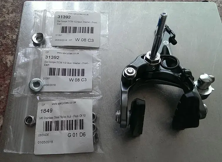

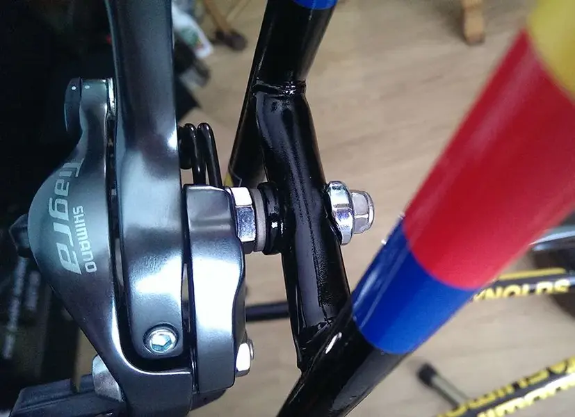

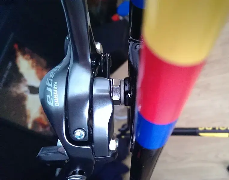

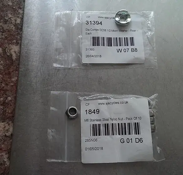

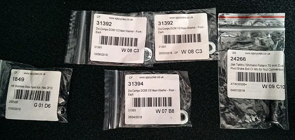

I wanted to revisit this post tonight to give something back to the community.
Firstly my brakes are finally installed. I didn't have to do anything extreme like drill anything or sell my calipers and buy new ones, all I needed was some correct washers and a 70mm brake caliper bolt conversion.
I have taken pics and part numbers which I hope will go to help any newbies like myself who didn't have a clue what to do.
I'd like to thank everyone for their help in this tread and for guiding and educating me so I could make this work, I really appreciate it, more than you know :)
