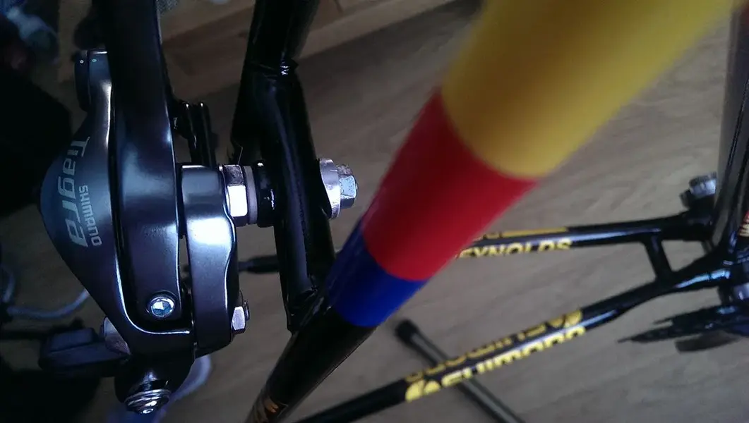

I drilled right through the rear bridge. The hole is so short there's no problem. However, this is with a bridge that has a 'tube-like solid' hole so the threaded bush supports the brake and is itself supported by the walls of the hole. With a more basic bridge with no 'solid' part it may not be effective.
Thanks for the posts guys.
OK for the rear I have just spun the conical washer around and removed the spring washer, it doesn't seem necessary in this application.
So we have the flat washer on the flat 'O' of the frame which is good and now the conical washer the right way round leaving a flat surface for a nylon nut, when I can get one :oops:
So then the only problem is the front.
What about this? And repeat as I have done with the rear, obtain a longer bolt assembly and add conical washer and nylon nut again? Does this sound reasonable?
I don't want to start drilling frame and forks because there doesnt look enough surrounding metal to get away with drilling, I feel it would affect the integrity of the hole, the sleeve with the Tiagra is only a few mm short of being same with as the rear caliper attachment bar on the frame :shock:

Unfortunately what takes about 30 seconds of spannering takes about 3000 words of explanation.
Heres how those concave washers work for the rear brake:
Dont be afraid of drilling but if you are, theres nutted brakes available, you'll have to check the drop

legrandefromage - I ain't asking for sympathy, I was asking for practical advice having never done this before. And I really appreciate the image and info, I just didn't feel the whole, ya bike looks cobbled together comment was necessary, how does that help anyone, especially a newbie? Maybe you never made a mistake, I dunno.
Not gonna debate it back and forth, thanks again for the picture, it did help and allowed me to see my washer was on wrong way round.
