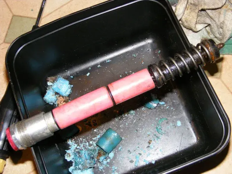

Hi folks
Sorry to dig this one up again but, being a Balance FS owner myself I'm interested to know of any other examples out there
I had the same problem of having one of the rear fork legs seized in place...seriously seized
If the current owner is yet to free up that stuck leg, perhaps I can offer some advice
You need to try to twist the inner and outer legs in opposite directions
Possibly by disconnecting the outer leg from everything and twisting it
Once I had mine opened up I removed the spring stack (which thankfully had not disintegrated) and cleaned all the greasy mud/gunk from inside, I could then see a couple of small corrosion spots which would have been responsible for the seized leg
A good clean and light sanding and they're as smooth (almost) as silk

I'm the current owner of this frame and it's untouched since the day I got it from UK Tyler
I'll dig it out sometime this week and have a play, see what I can apply from your experience to this frame and feedback

Just fitted some fresh elastomers this evening so I can't wait to try it out tomorrow (playing with my toys when I should be at Muay Thai class :roll: )
