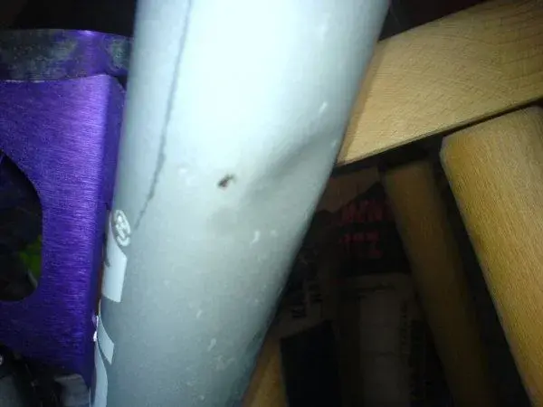

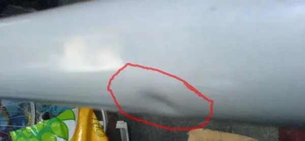

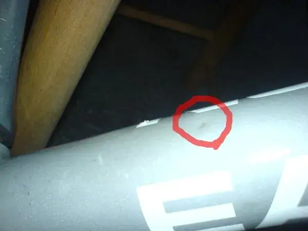

there is one big issue though on which i'd like to have your opinion. the frame is badly dented :cry:
i attached some photos that show them. especially the dent at the down tube (see yeti-arc-dent3.jpg) looks intimidateingly huge. how save is it to ride that frame? is there a way to repair it?
thanks!

I'm definetely no expert, but if you're only riding light xc and not doing anything too crazy, I can't imagine it's terribly unsafe. It doesn't seem to be in a critical stress point on the tube (I'm guessing...again, no expert), as it's not near a weld. I wouldn't go as far as to say it can't snap, but I think you'd have to push it pretty hard to do that. As well as riding style, your weight could also be a factor to take into consideration. I'm a feather weight, and probably couldn't break a frame made out of dry spaghetti...
That's my humble two-cents worth, but hopefully a more knowledgeable person will confirm or destroy my theory.
No problemo! :wink: I'm really pretty sure it's safe for light xc (no drops and jumps for sure), but don't want the guilt if it breaks under you... :oops: Thus my caution. I'm also not there to physically see it and touch it. At the very least you can make a cool SS commuter. Dented frames are great for that, and they get a new lease on life.
PS at 60 kg I'm not even sure it's a joke...he he. :lol:
That's not so heavy, so weight shouldn't be an issue. That leaves riding style. Most of my friends ride primarily xc, but some ride harder than others and just seem to push their bikes more. The guy I ride with every week weighs about the same as you, and even though we ride the same trails, it seems he can smash just about anything on his bike (except the frame luckily.) Our friend is a mechanic and we always have a good laugh about what's broken "this time!" One of friends managed to snap the down tube on his steel Voodoo, but he rides pretty hard (North Shore on a hardtail with 2 meter or more drops...he's pretty talented on a bike though and can ride anything. We hate him :evil: ) I think you'll be good if you aren't a maniac, but would still like to hear what some others have to say.
You should put up some pics of the whole frame just so we can get a look at it as a whole, and not just for the dents.
