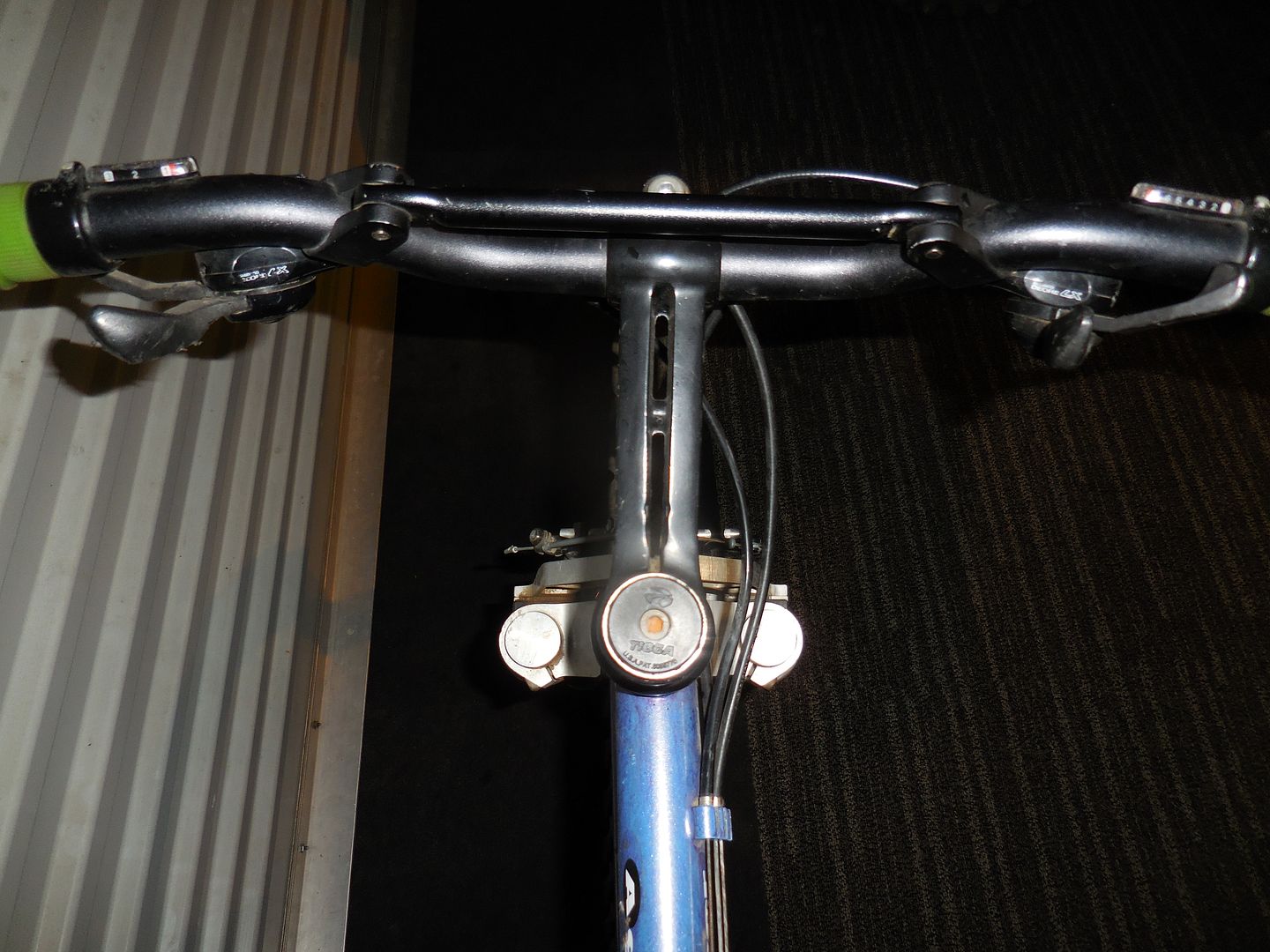

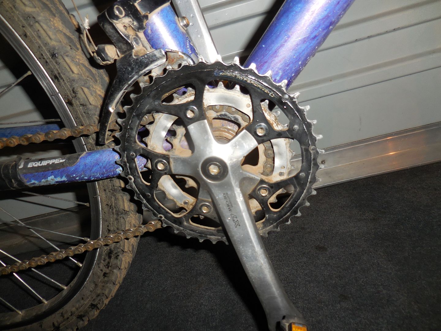

Anyway, this bike appears to have a complete LX groupset intact. The rear rapid fire has failed, not sure if this is repairable? The shifter is integrated into the brake lever.

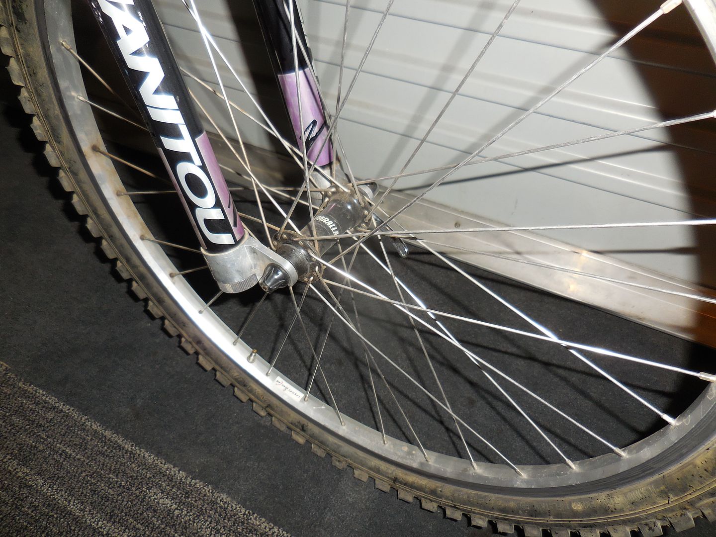

The Manitous look OK but the elastomers are cactus, as to be expected.
The wheels also appear to be original and straight.

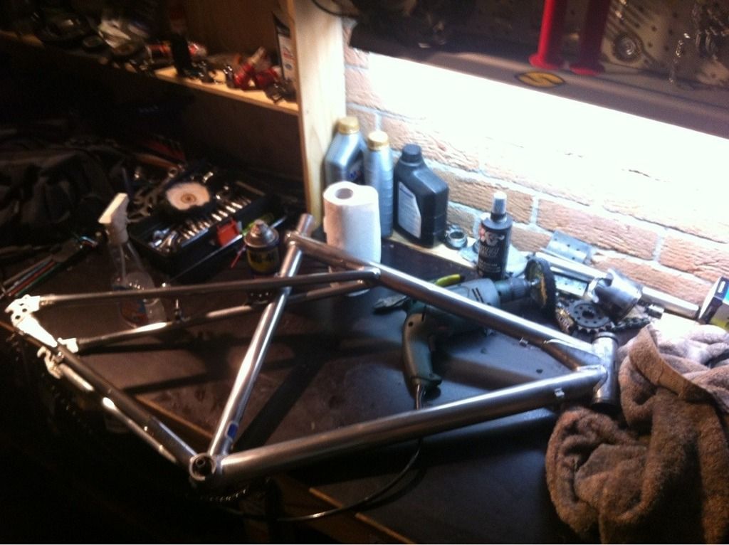

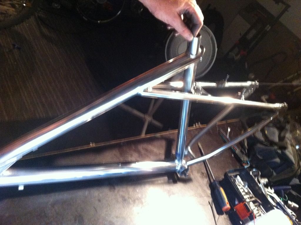

Was looking to build a Hans Rey tribute bike for real trials use out of this old Avalanche frame. Yeah I know Hans rode a Zaskar, but I came across this cheap and thought it would serve the purpose.
Anyhow, I will do a complete strip and inspection soon, weigh up the option of restoring vs value of parts and go from there.

what's wrong with the rear shifter? Old rapid fire shifters commonly get gunked up with old grease and the pawls inside won't engage the ratchet- the levers will just move freely without any shifting. I had to take the lx's off my '93 karakoram and all i did was clean out the old grease and spray some silicon lubricant in there and mine are working fine now- give that a try eh?
Thanks for the tips...........I had a good look at the shifter.
One paw was stuck in the open position due to dry grease, and another had a small rock wedged in there.
Some brake cleaner, manual operation back and forth, and some new lube fixed the problem. It works like new. Just a few turns to get the derailleur working (it had been manually locked in 4th gear) and all was like new. Amazing how good this old gear is!
