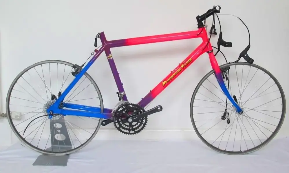

I’d made some progress on a 1989 groupo when this popped up a few weeks ago💡💡 IMG_5913.JPG
Move the Deore XT over to the Funk and use the XC9000 on the Klein...

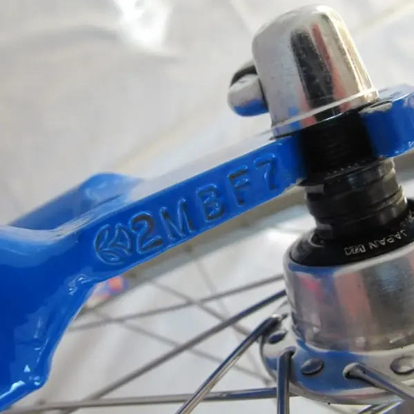

Hopefully someone can tell me more, for example is it 1988 or 1989? The frame number (can I call it a fuselage, even though it’s a Mountain Klein?) is: 2MBf7 and there’s also a number 30 on the other dropout if that helps.
There’s not much on-line but the “Aurora” paint scheme isn’t listed in the 1989 catalogue but I can’t find an 1988 catalogue to compare against.
I could also do with some suggestions for rims, seat, stem & bars. Was a Mission Control stem/bar combo available in 1”? IMG_5913.webp IMG_5912.webp IMG_5908.webp IMG_5886.webp

So the number is very high, 3063rd MK built, which would peg it close to 89. However, the 30 stamped on the other dropout indicates 130mm rear spacing which means it predates Shimano XT II which was in 88, so that makes me think 1988.
Excellent frame!

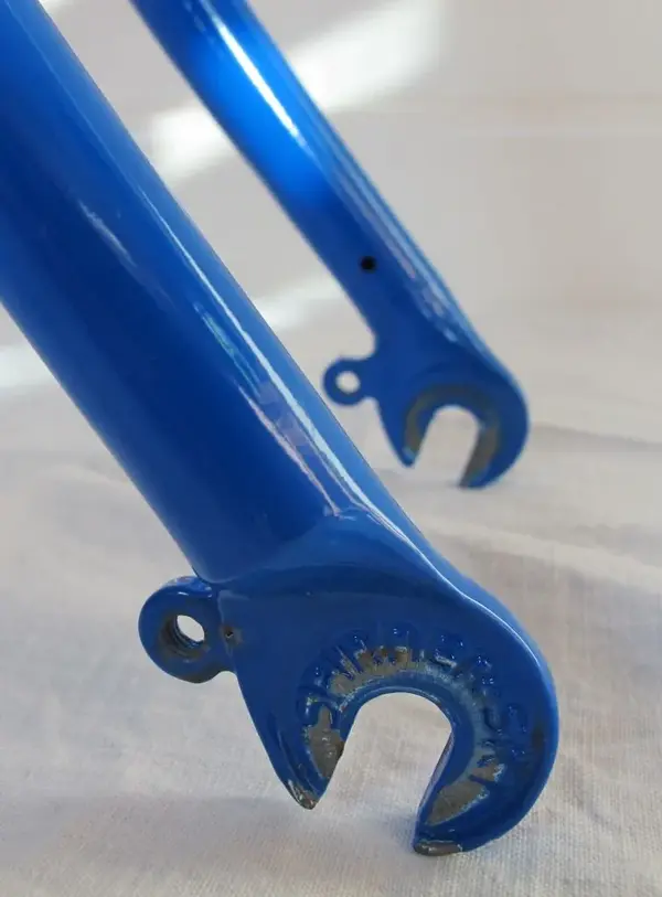

I have 2M992 in the basement. I had always assumed it was a 1987 or so, but I never got the Klein coding system. It has a U/Roller brake on the lower rear stays,spinner fork, and the 2nd Gen (??) cable routing below the year stay.
I guess yours isn't too dissimilar to this one on eBay at the moment? But what’s 2G cable routing?

That is the same frame generation as mine. I wish mine looked like that though. Mine is bare metal and a size smaller. It's faaaaar down rebuild list.
