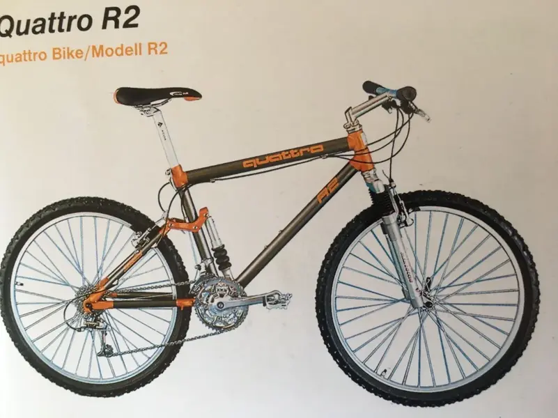

The frame is a '95 Wheeler built by Gally in Germany, and then rebadged and sold to Audi drivers of the time. I presume through their car dealerships, although not entirely sure.
all correct
Quattro was also the name of an accessoiry line from Audi back in time
The bike was sold as "Quattro R2" mostly in dark/orange color
But some also in different color scheme, e.g. there was a "pro" variant with Rond fork and Magura HS brakes

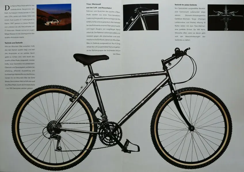

BTW: there was an to me even more iconic Quattro Bike.
The 1989 Quattro model Pikes Peak, based on a Litespeed, similar to Marin Team Titanium and sold from german Marin Dealer to the Quattro GmbH
There is a nice documenation https://k-i-n-g.ch/de/audi-quattro-pikes-peak-de
