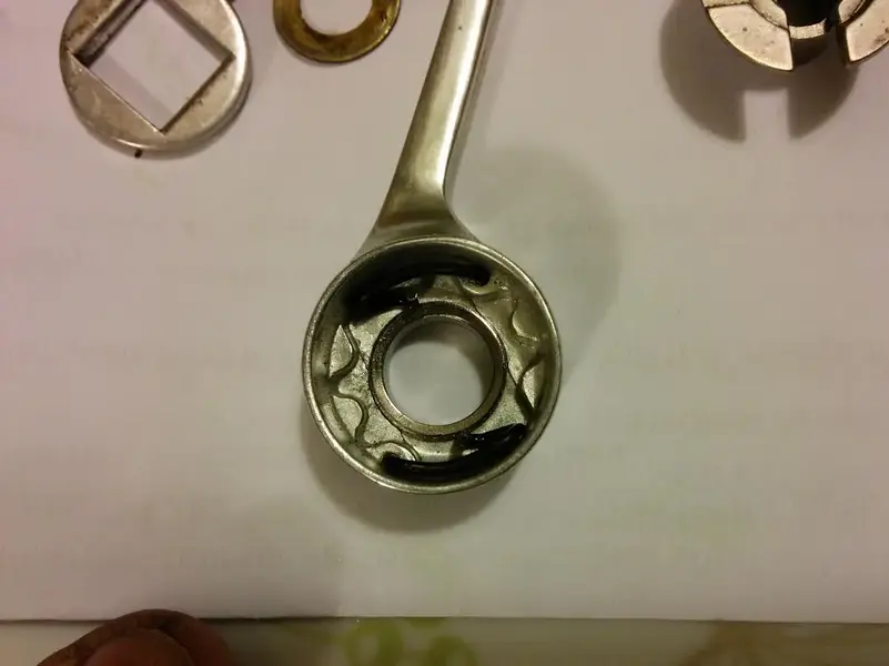

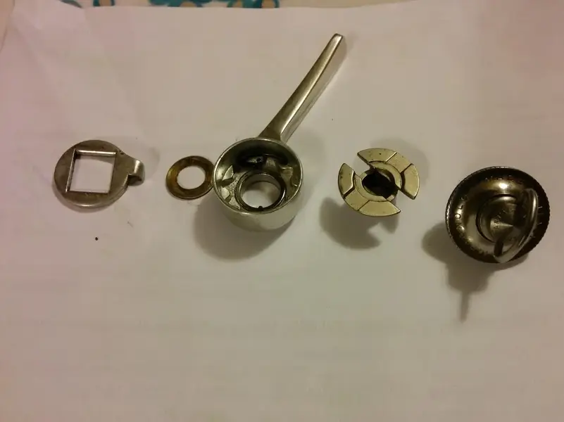

Not much beats me but I'm just building my Mino Denti Master. Got to the shifters but
can't get any fiction what so ever out of the rear mech shifter. I'm
pretty sure I have all the parts and in the right order Left to Right. There are 2 springs in the lever body????
Anyone any ideas
Ta
Paul

I'm pretty certain that lever body is for an indexed lever, I've never seen a friction one with springs like that, they're usually just two plastic washers and a few metal ones.
