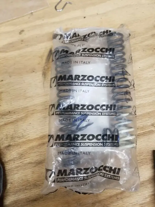

I think this might help. I know the hard springs 180lbs+ are white (7,5). The Extra Hard are Red (8,4)
Stock Marzocchi oil is Golden Spectro 125/150 which is 7.5W oil.
Springs for the original & older 65mm Z2's are 150mm in length. Approx 17mm inner & 24mm outer dia.
Springs for the later 80mm travel Z2's are 165mm in length.
If you happen to need the white springs for a 65mm Z2 I've got a set on ebay.
