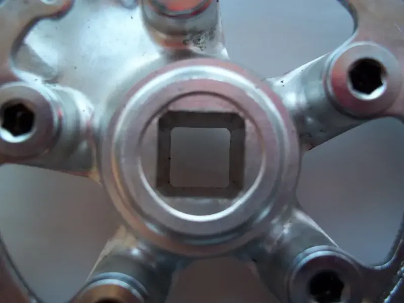

Here's a photo of an M737 drive side crank of mine that is definitely a good 'un, sorry I couldn't persuade our rubbish camera to focus properly.
Think FluffyChicken is right, the sides of your squares bulge out past the corners on closer inspection.

there will be a bit of bulging if it was clamped tight against the end stop. I wonder if someone has placed it on an ISO or shorter JIS axle (iir Syncros are a bit shorter than noraml) and clamped it down far to hard over time.
Either way I'd just look for some more arms :-(
Or see if the newer shimano bottom brackets with the chainline stops clamp it down when you hit the stop (like ISIS do).
Hmmm your measurements match mine quite closely, got to br the crank then.
The fact the hole on the inner side is 0.2 mm than the spindle says they're knackered.. send them back for refund.
