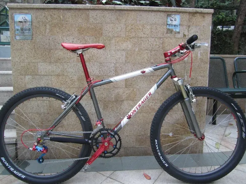

Forgot to say, GoldenEra, I am pretty sure that Henrik Djernis won one or two of his world champs on a Ritchey with an extended seat tube like that Empella so that he could reduce the weight of the bike.
Did not know that, thanks. I'll have to look around for a photo of that.
photo credit to veloculture(I think that's who I stole it from) on the VRC forum. there's a few more I'm having trouble finding

hollister":2r21wrzt said:
GoldenEraMTB":2r21wrzt said:
there it is; cool, thanks. Now I have to share a photo with you; check your messages later today 8)
