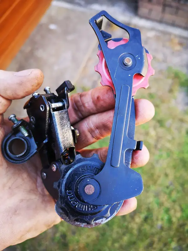

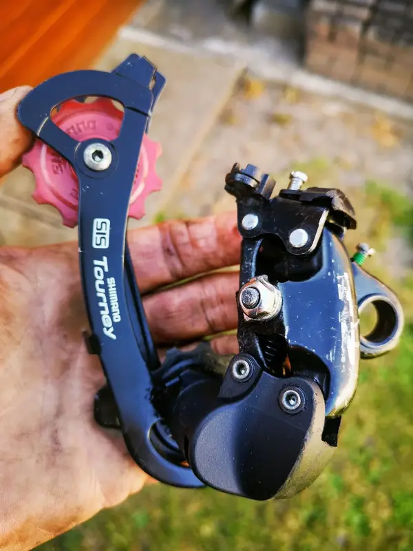

Here's an old derailleur cleaned by the power of ultrasonic ... It was taken out about 3 or 4 times & scraped off what was soft! It saved me a load of time from striping it to clean!
