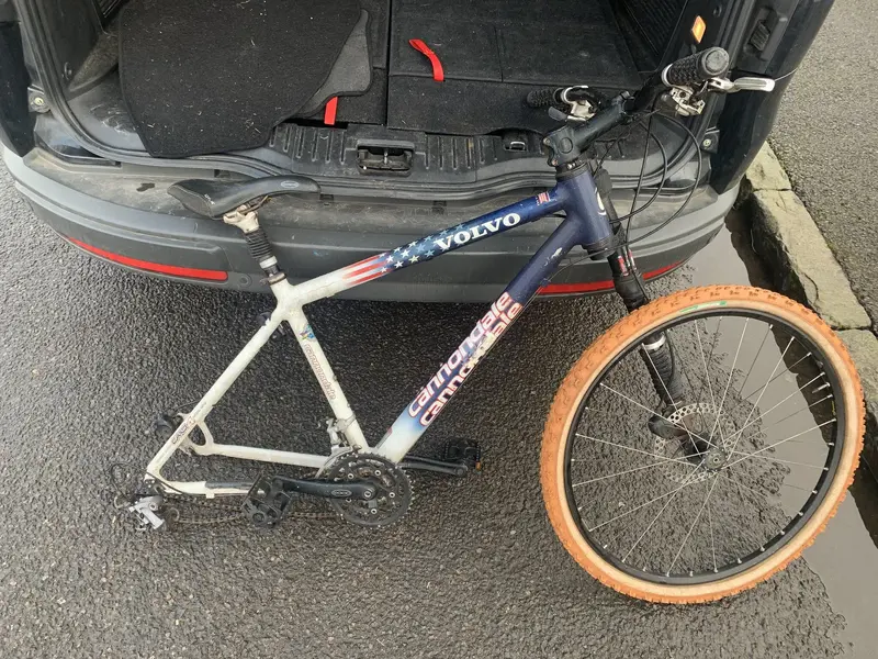

Bought this 2000sx Stars and Stripes cannondale with a missing rear wheel and seized fork. I’ve kinda had a look at it but I wouldn’t know where to start tbh. Looking to see if anyone on here does them or in the uk (I’m just outside Edinburgh so somewhere local would be ideal but I’m happy to ship it too)
Thanks in advance

Update…..
The fork is working, it had not been slid all the way upto the top of the clamps and the part that connects the lockout lever to a nut inside the fork weren’t connected so easy fix but I’ll still look into the price of a service
