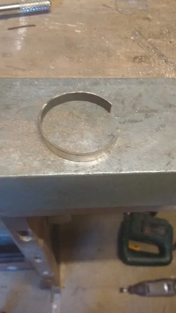

So, have been working out how to ditch the rivets in favour of bolts. The problem to overcome, is to provide something for the bolts to screw into on the 'blind side'. It would be possible to try and solder some nuts on the blind side, but it runs a risk that should the solder ever fail, the bolt and nut would simply 'twizzle' and therefore make it very difficult to ever dismantle again.
For the firebox I have fabricated two small brackets from a brass curtain rail, into which I have tapped the relevant bolt holes.
For the smoke box I have made a brass ring, again into which I can tap bolt holes.

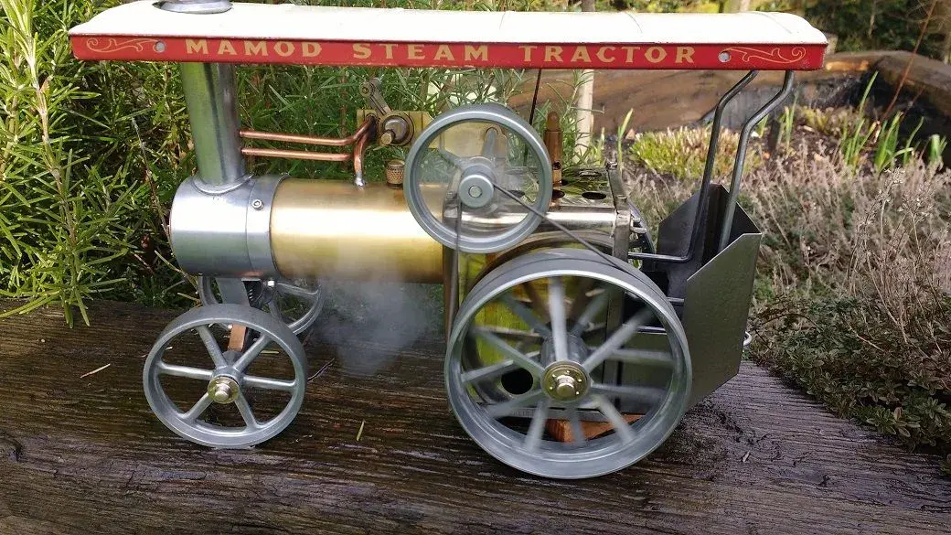

Apart from allen head bolts to replace canopy rivets, the rebuild is finished. Have kept the bare metal look. Canopy is in good condition, so have left it be for the time being. Steamed it up today, first time in 25 years after languishing in the attic. Ran fine in all four forward speeds, and three of the reverse.
