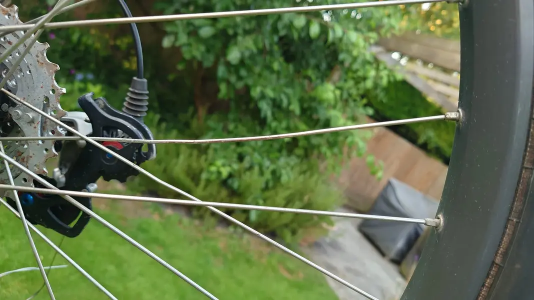

I have a second hand pair of wheels that I think have been poorly built. I'd like your opinions please, what's my best option?
The back wheel has 1 very loose spoke, the issue is there no threads left on the spoke so can't tighten it. None of the spokes on either the front or back wheel have any visible threads so making any adjustments almost impossible.

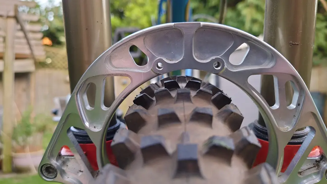

The front wheel isn't central in the fork, so don't think it's been dished correctly. Like the back there's no threads more threads on the spokes.

You really need a dishing tool to check for sure, could also be uneven int he dropouts or even just a unevenly seated tyre that causes the wheel to look off centre in the forks...
The spoke in the top photo looks like it has taken a whack it could be that the threads are damaged - it would need replacing

This is what I thought, my guess is that they were not built by a professional.
