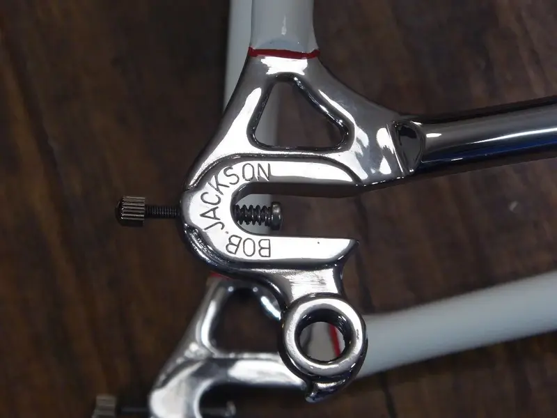

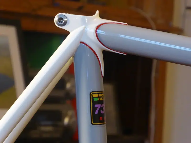

Like many on the forum, I’ve used Bob Jackson and very happy with the result. The other week my partner found the receipt lying around from BJ for the work I had done last summer (alarmingly bad filing on my part!) but returned without comment. This covered a repair, some chrome and repainting. Chroming the drop outs and drive side stay came to £132 and enamel paint (2 colours) and lug-lining was £208, totalling £340 (decals, repair and re-tracking on top of this). Here’s a couple of pictures or look at the thread viewtopic.php?f=23&t=375875&hilit=Bob+Jackson+731os&start=0 . Bike’s been built up with modern equipment and is back doing long and comfortable rides, still getting admiring glances.

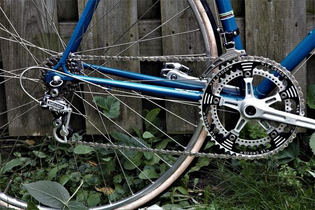

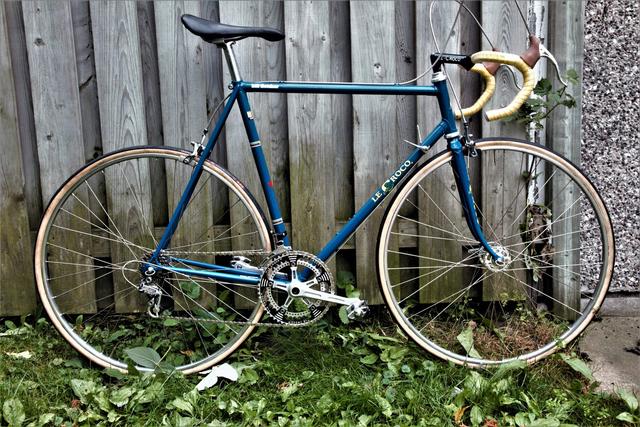

I just finished a rattle can job on this Canadian Le Croco. Paint still needs to be buffed out in spots but I am happy with it. I use an old wardrobe cabinet with 2 heat lamps which heat the cab to 140 degrees F. So 2 weeks after final clear coat it's ready to go.
