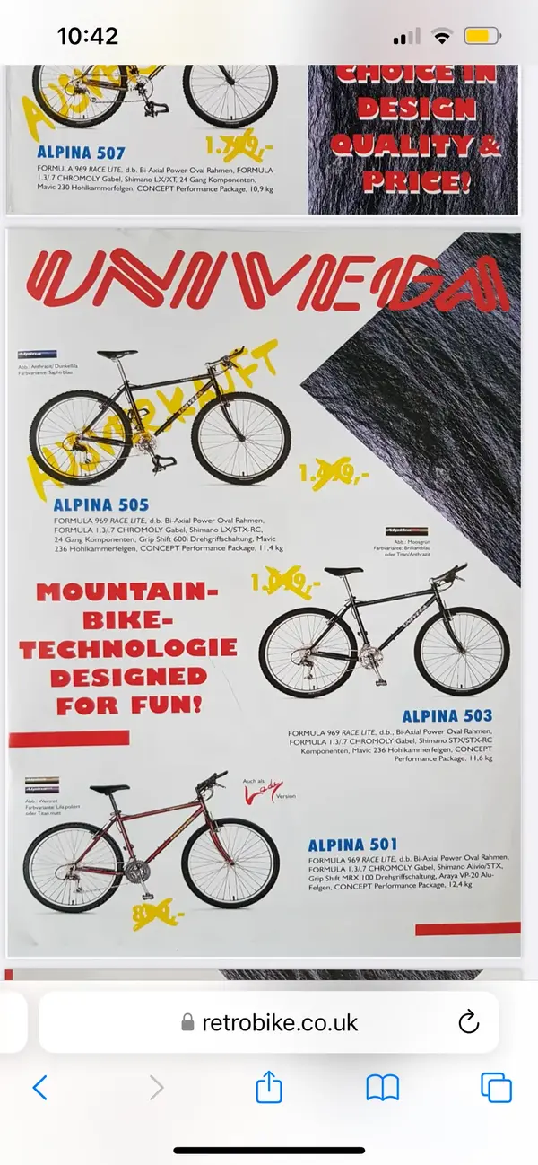

I have an old Alpina 503. Still in good condition. The only part that has been changed is the back wheel because it was stolen. Keep in mind it’s a long bike.
