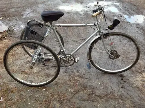

Hi everyone,
Have recently purchased a 1950's Hercules bike, with a Ken Rigets trike axle conversion.

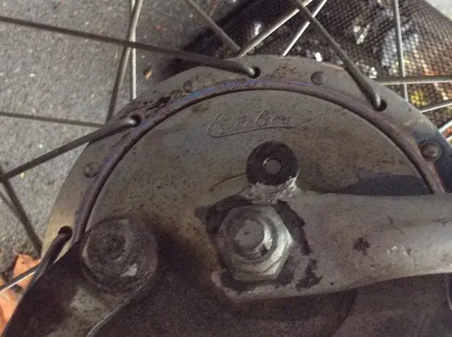

However, to comply with a bike needing two brakes, a previous owner fit a front hub brake. The last owner was told it was a 1940's tandem hub brake, but that was only hearsay.
Anyone throw any light on it?
Regards
Mark

The brand is "Exceltoo" - a French company from St Etienne. As well as bicycle hubs, they also made hub brakes for Solex mopeds.
The front hub looks like a tandem hub, large flange and 12 g spoke holes.
There used to be several ways of mounting 2 caliper brakes on the front.
I sold several similar new conversions from The Holdsworthy Co. in the 1950s.
Keith
