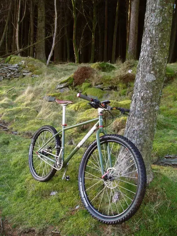

I had the second ride on the (at the moment) Alfine 8 equipped Hummingbird today, just scratching around in the hills and forests behind my place.
At the minute I've decided on -
Things that I like -
Quiet, smooth drivetrain.
No rear mech to get caught in the heather and branches.
Nice gearshifts (mostly).
Hub appears to be nice build quality, looks pretty enough too.
Plenty low enough bottom gear (with 22T sprocket).
Fast engagement (if a bit softer than I'm used to).
Spot on chainline with Middleburn Uno (47.5mm).
Ability to change gear while trackstanding.
Things that I don't like :evil: -
The extra weight (but no surprise there).
Shifter that works ok but looks cheapish (and isn't :roll:).
The worst change is 4th to 5th (which is the 1:1 ratio unfortunately).
Anti-rotation washers that wouldn't suit my dropouts - I had to get the welding gear out and add some custom lugs to them - 500% better!
Tacky looking acorn axle nuts - they had to go in favour of some red ano. ones.
However, having ridden singlespeeds almost exclusively for the last three years, I've reached the conclusion that I don't actually like climbing in low gears if I can possibly grunt my way up in my usual SS ratio, which is 32:20 - I found myself changing down and then almost immediately changing back up to 5th again (which is 32:22 in my case).
I also find technical stuff harder with gears at the minute, as unless in 5th, I don't seem to have the same awareness of how far a pedal stroke will take me and how it will get me up a step-up or boost me off a ledge.
I miss the "hard" engagement of a Hope Pro2 too...
Still, it was nice to have the luxury of a bail-out gear or two for the stuff that would otherwise have me walking, plus a higher gear for climbs that otherwise wouldn't let me be out of the saddle.
I noticed the weight especially when doing endo turns on downhill switchbacks - it just needs more forward weight transfer.
So, how long it'll be until the SS wheel finds itself back home again, who knows? I bought it and built the wheel to - a) amuse myself, b) scatch my IGH itch and c) to in some way future-proof my Hummingbird for when I become too old and frail to ride a singlespeed reasonably well (you think I'm joking?)

I don't find the shifting from 4th to 5th to be a problem - just that it feels slightly less slick than the other changes, which I find to be pretty damn good, if I'm honest. As you say, it's because this is the point that the change from reduction to 1:1 occurs.
Actually, I understand that Shimano have given their tacit approval to use of the Alfine for mountain bike use, certainly the S501 roller clutch version anyway, hence the marketing of the likes of the Genesis IO ID.
The anti-rotation washers? Well, yes, the blue and green ones do work on the Hummingbird but I didn't think that they were that wonderful for the following reasons -
The dropouts don't actually have any parallel portion at all - you have a 10mm dia. section and then the front and rear faces are radial to this at an included angle of about 60°, so the "anti-rotation" washers don't actually locate by default - you have to rotate the whole hub anticlockwise (drive side) to locate them against the front of the dropout and then remember to tighten the NDS first, otherwise the act of tightening the axle nut on the DS tends to rotate the spindle to where the washers aren't in contact with the frame at all.
Anyway, I used the black and grey versions, ground the lugs off and welded on new ones which a) fit the dropouts perfectly and b) position the cable attachment exactly where I want it. They also have the advantages of taking up the clearance between the 10mm dia dropout and the 3/8th dia axle, spreading the loads over the whole forward face of the dropouts and reliably and accurately self locating.
Necessary? Probably not, but they don't offend my engineer's sensibilities as much . :wink:
I probably notice the weight change even more than you, coming from a singlespeed setup - although it's actually the CoG change that's most noticeable to me. I think the 3 speed hub is the Nexus, but it has an axle end type cable connection which I reckon would last about 10 minutes, even in my hands..... :roll:
Anyway, as you can see, my Hummingbird is considerably less salubrious than yours, being an odd mix of Hope, CK, Middleburn, SKF, Magura, Easton, Thomson, SKF, Salsa and Sun-Ringle. A bit of a dog's dinner of whatever stuff I had lying around, I suppose.

looks good :D
love teh additional work to the anti rotation washers.
what chain ring and sprocket size are you using?
i'm running 32 and 18 at the mo.....
