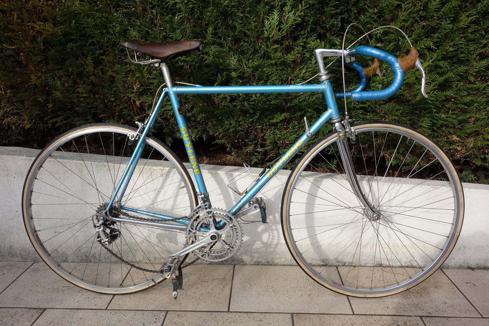

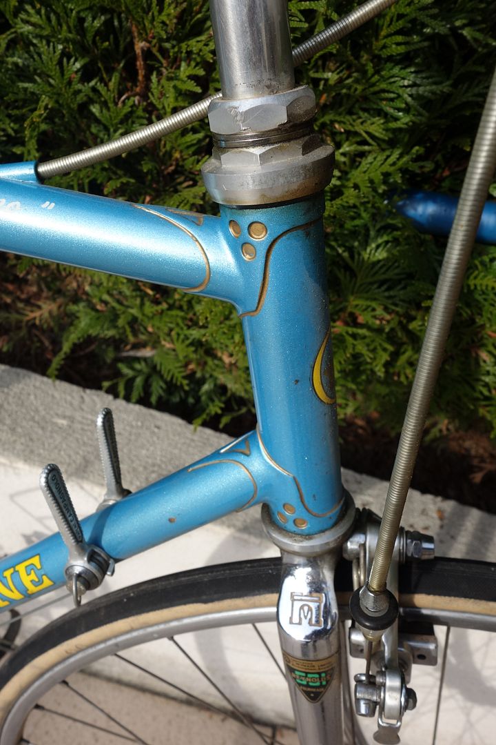

I confess I was not enamoured much with the frame, so here is anothe bike which will be built along "weight consciousness" but with international parts!

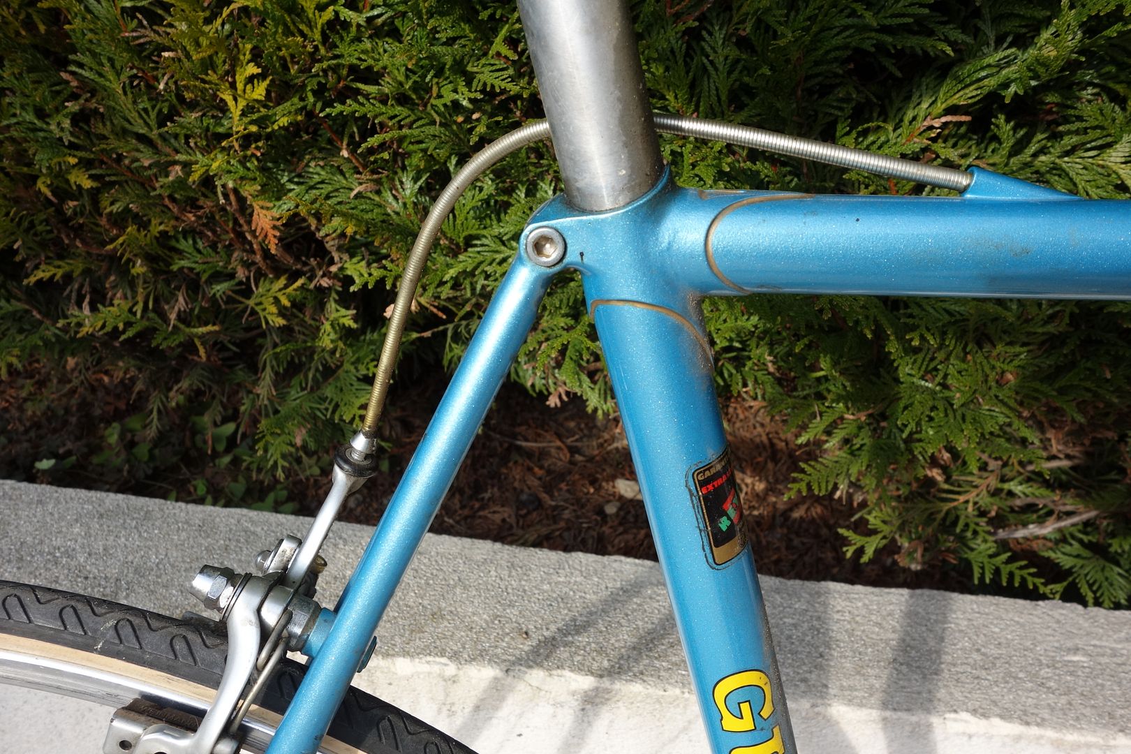

It is a "Alain Michel".
He was a small framemaker in the vicinity of Paris, mostly for keen cyclist , good amateurs or pros.
I really love the seatstays ( which are very similar to this later 90's bike of mine )
viewtopic.php?f=23&t=290542&hilit=alain+michel
This one is out of Reynolds 531 SL for the frame and 531 for the fork.

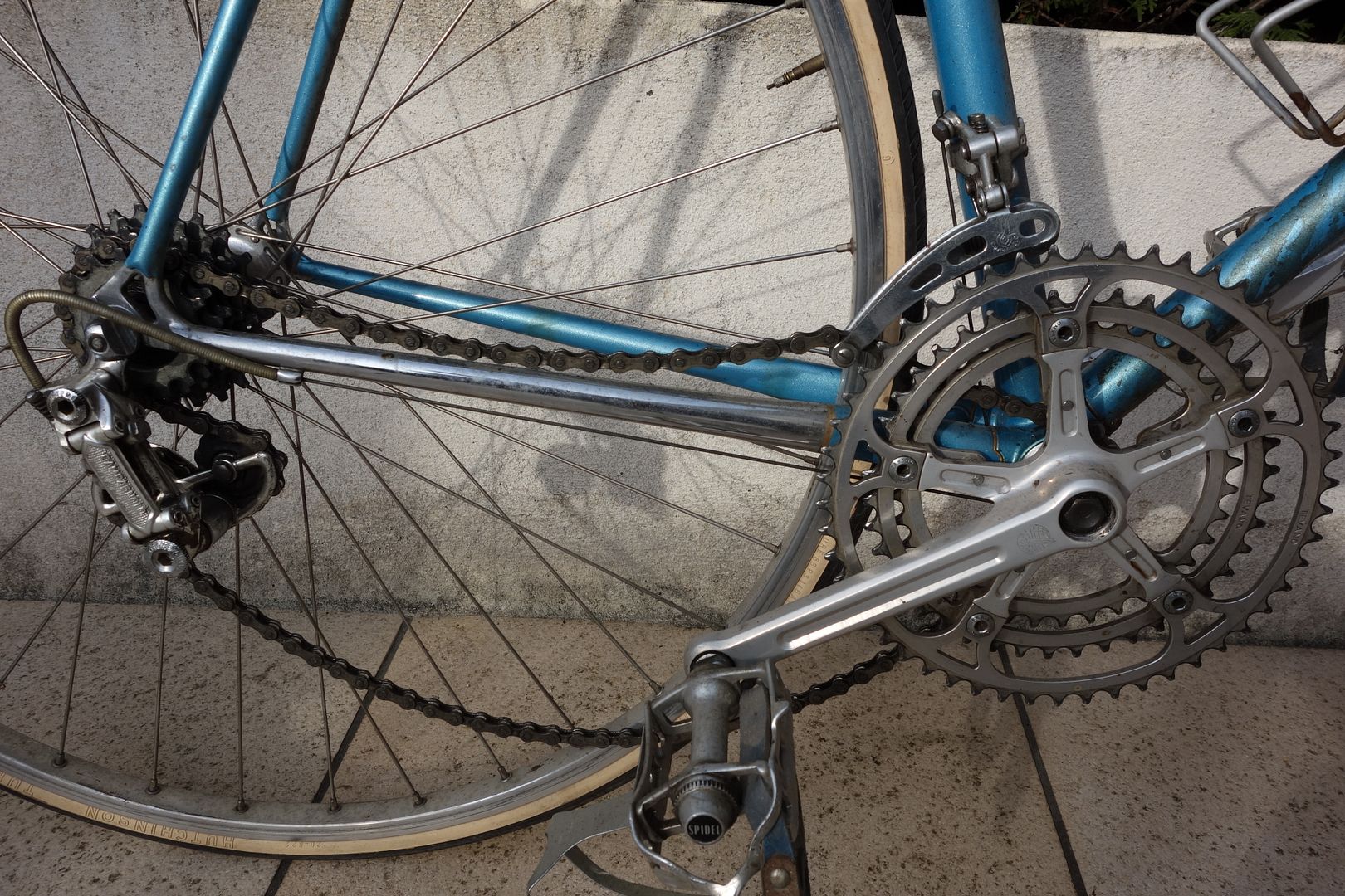

Presently with very mixed parts - will change parts in a weighweeniish manner , so change the mechs the saddle, the seatpost , but leave the very nice OMAS headset. Not decided on the calipers yet or crankset. May probably leave the Tevano triple which is rather light ( altered like some campa cranksets and my old bones don't mind at all :lol: )
so possible Jubile long cage at the rear and jubile at the front :idea:

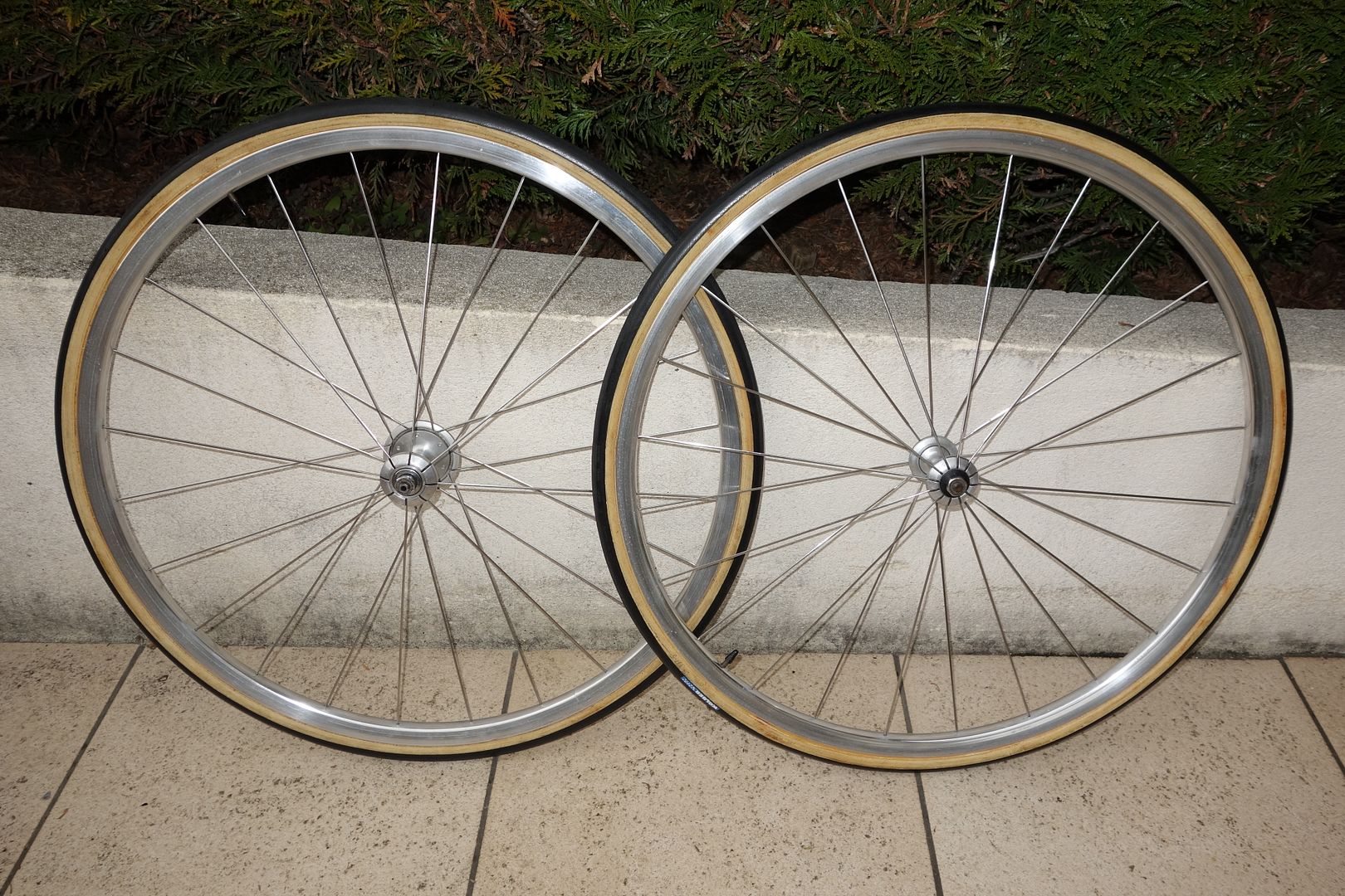

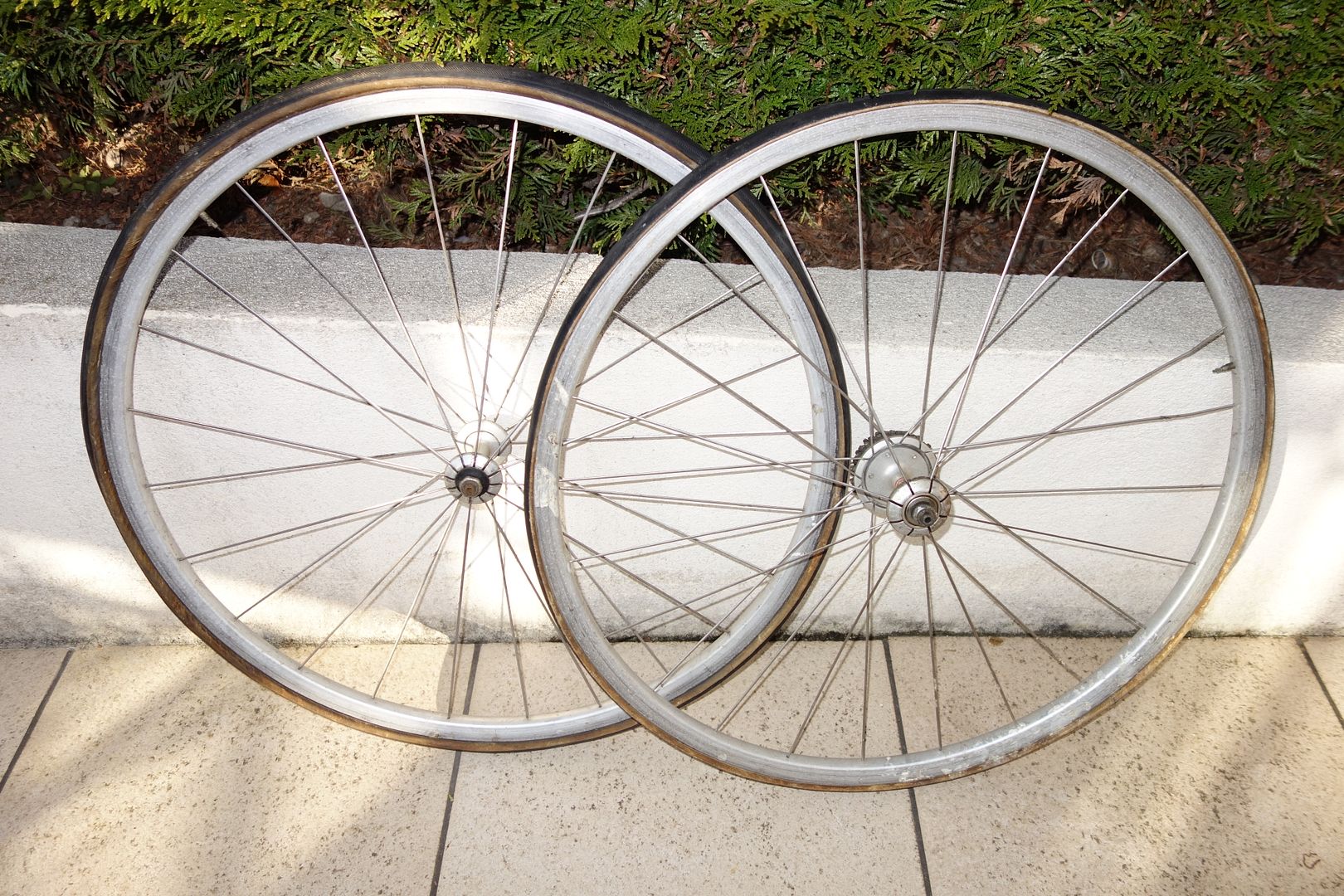

here are the two wheelsets for the bike

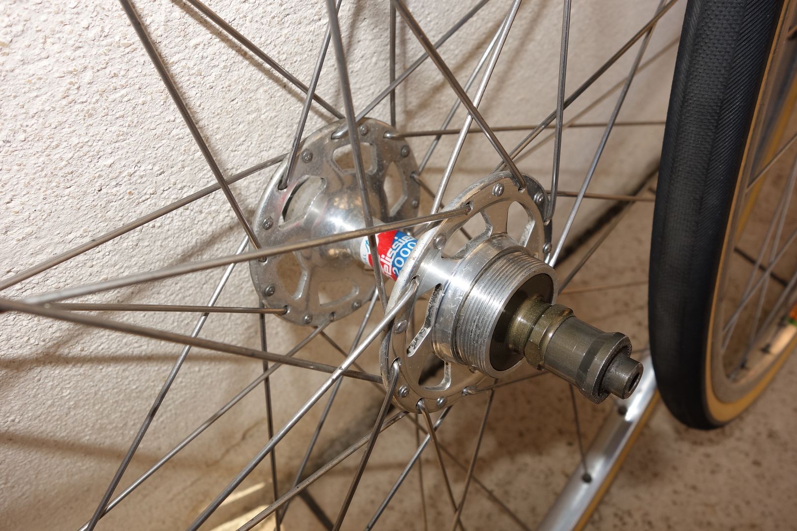

a clincher - Mavic Module E on Pelissier 2000 Professional with annular bearings
First time I bought some Veloflex Master 25 tyres
A pain to mount but apparently very nice as comfort seems close to tubulars and they are pretty light
and a tubular one - to clean

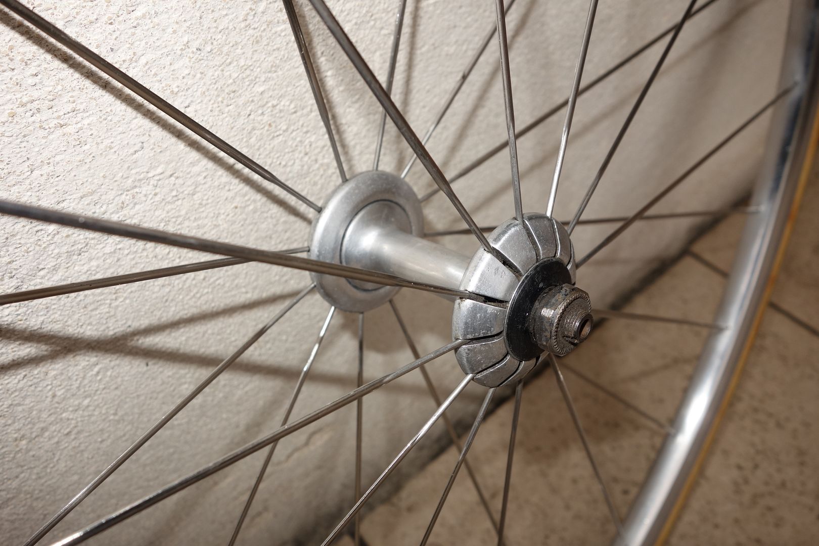

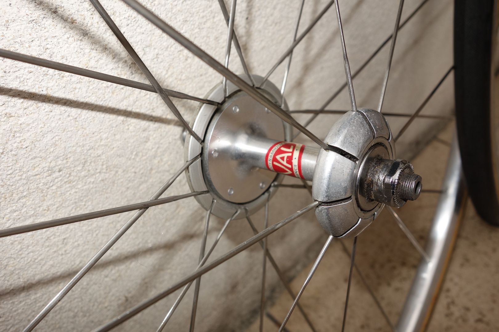

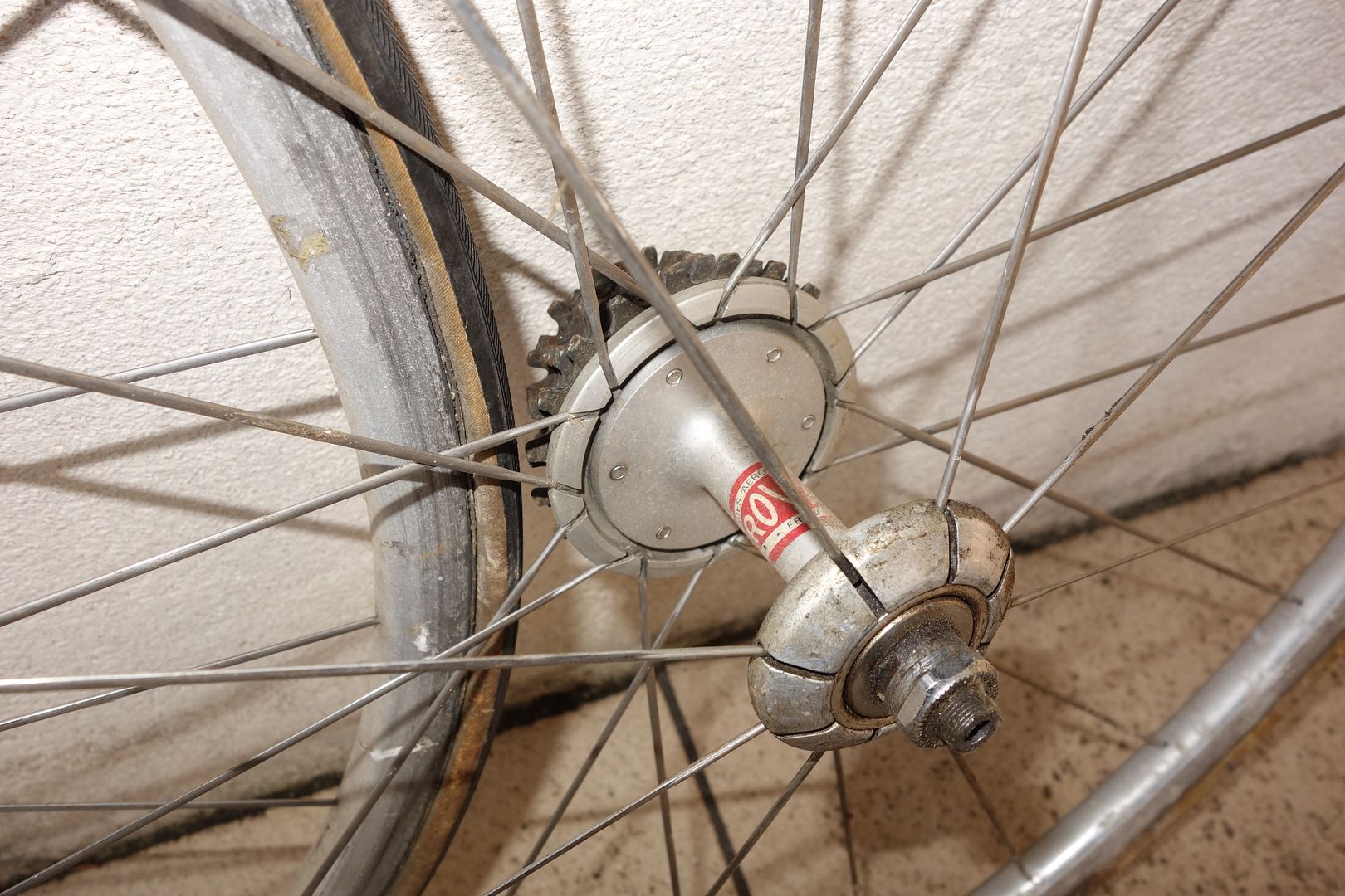

a Roval wheelset - 24 spokes each wheel - quite original hubs with profiled spokes 8)
one spoke is probably broken but hopefully, I have got one for repair
The Roval wheelset is really quite special, I like your project and I'm following with great interest.
: Mike

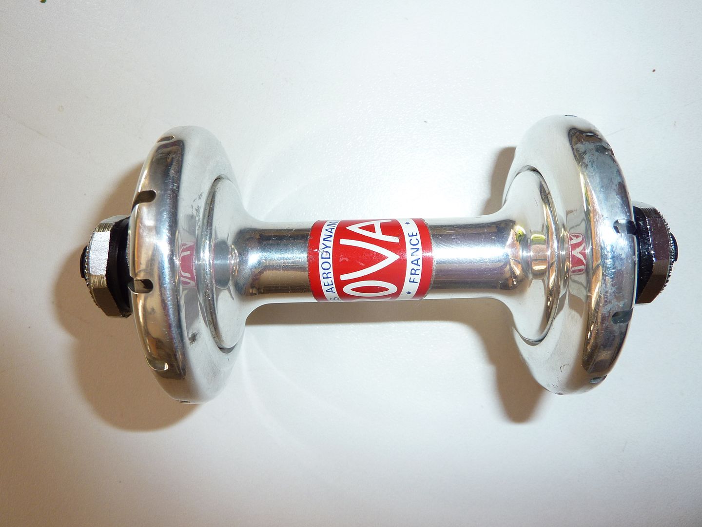

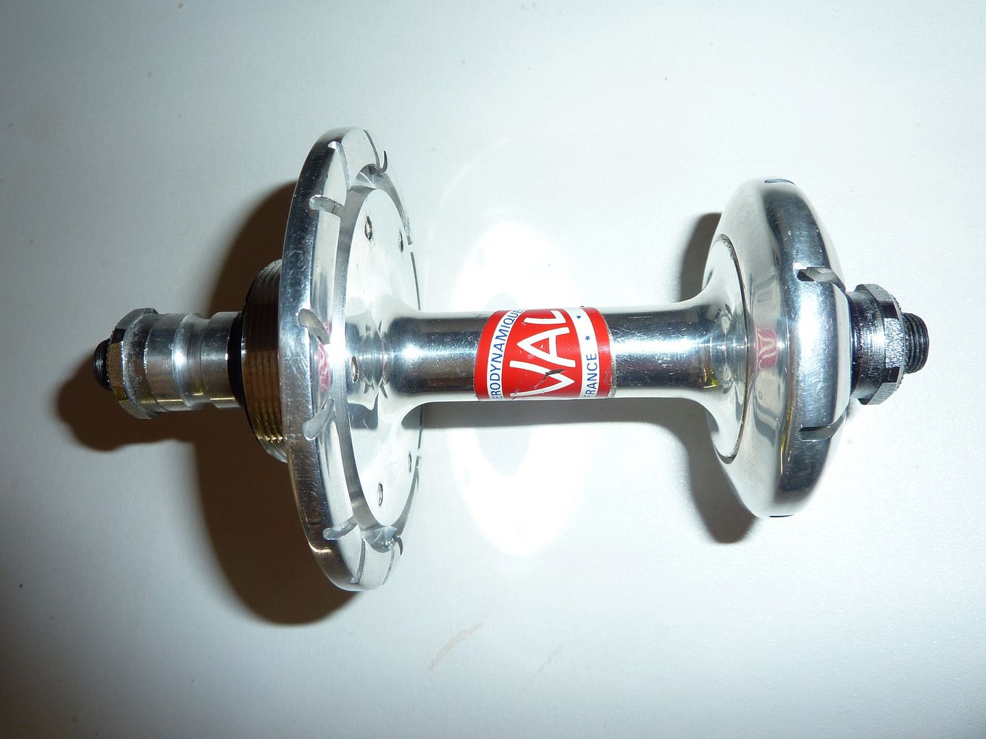

Yes these Roavl hub are the most striking french hubs from the 70's
were fancied by the TT guys - a sort of first try at a more aerodynamic shape !
but the wheel is actually not very light

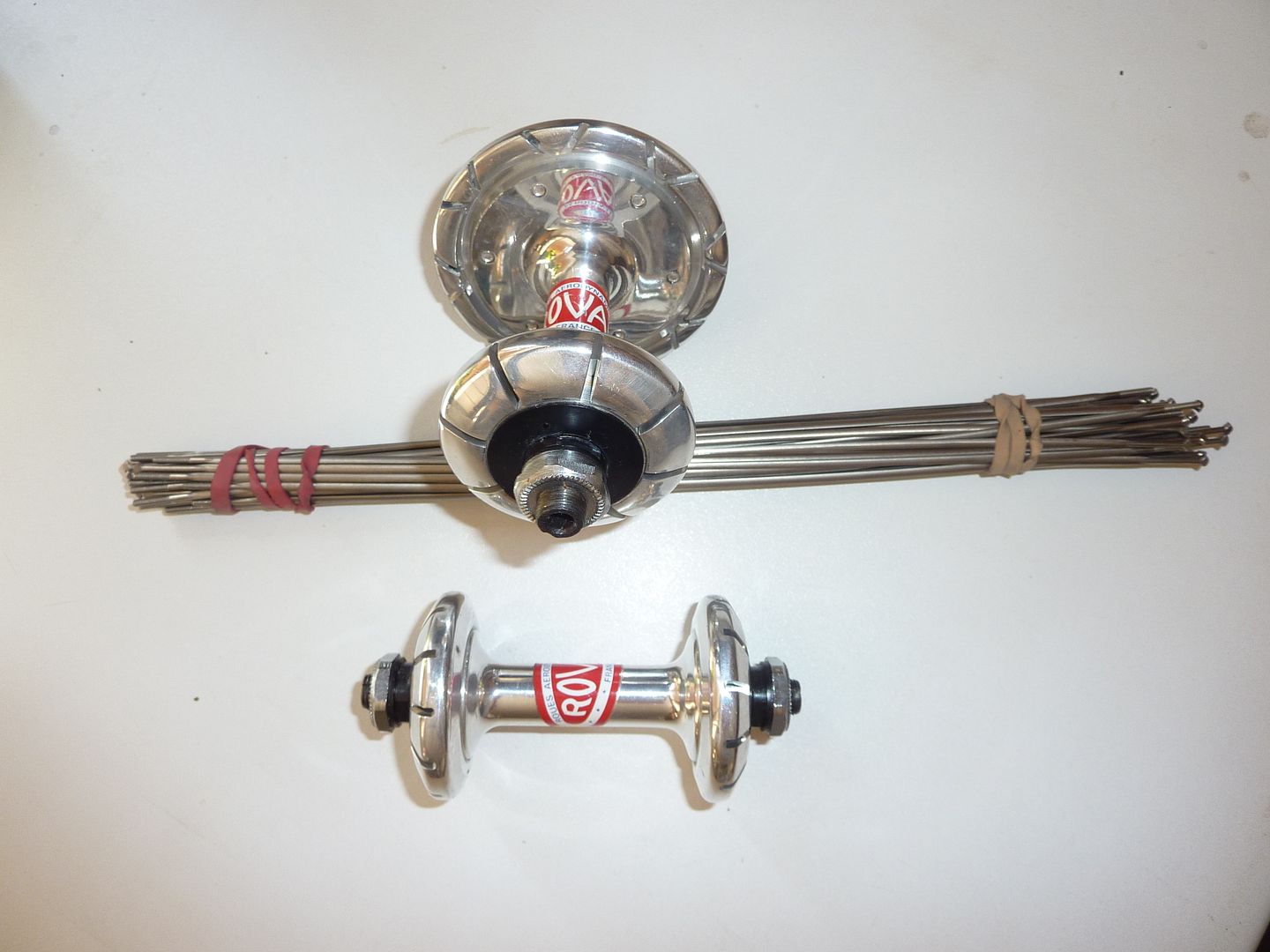

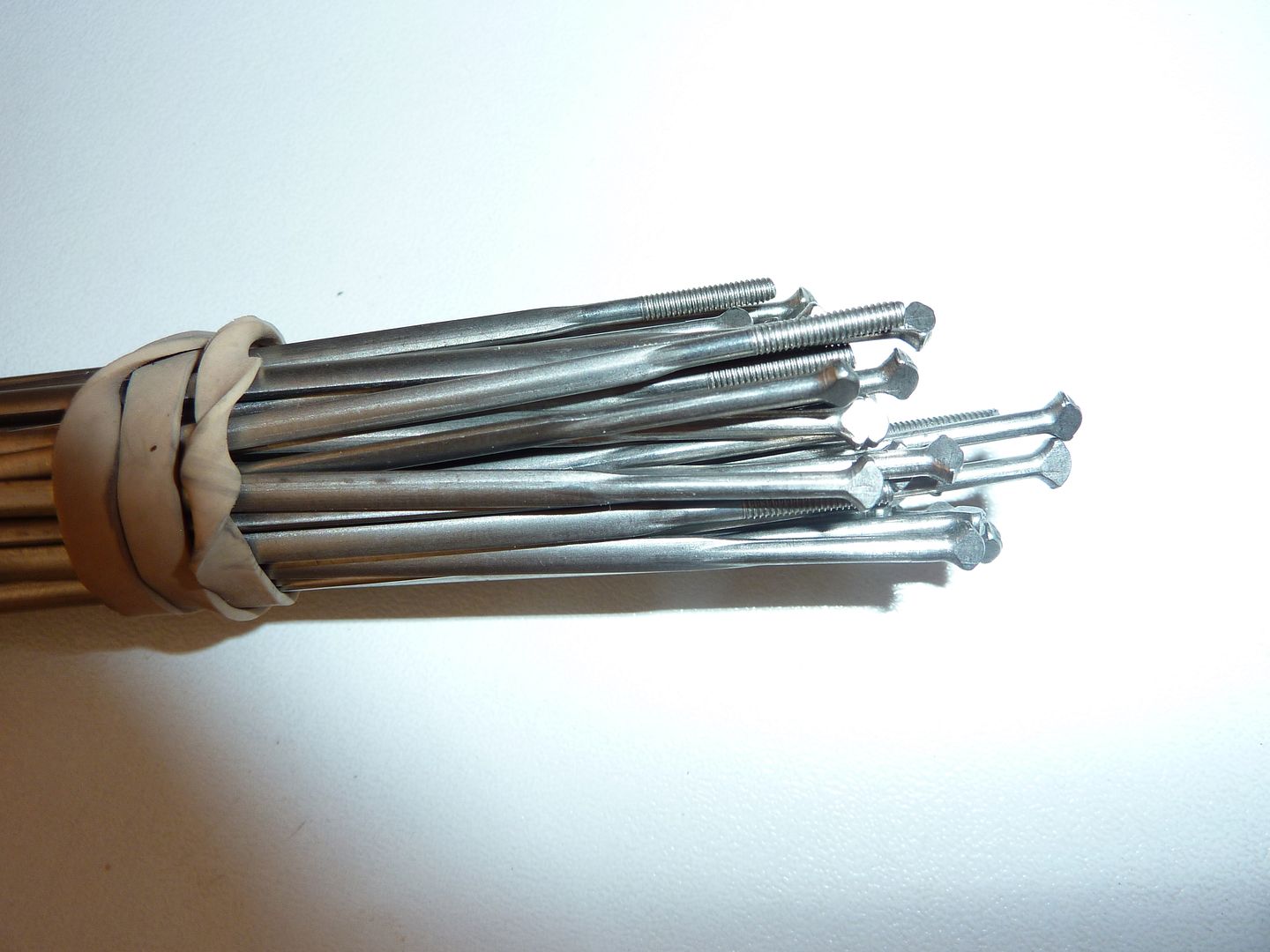

here is another pair of hubs unmounted

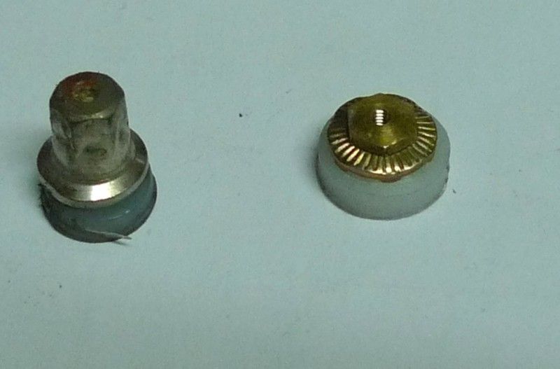

the spokes are very special, as well as the nipples and washers - the nipple is actually "drowned inside the rim with a specific plastic deep washer )

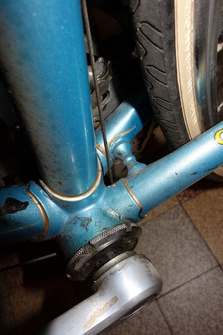

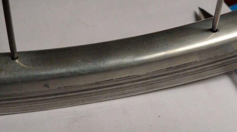

Bird droppings are a pain in the neck , and they were a few spokes to fix - luckily none broken - but a bladed spoke is tricky to straighten :roll:
