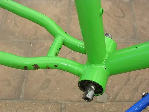

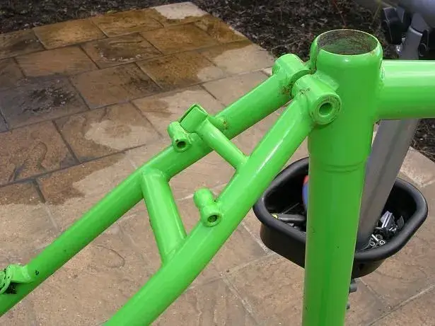

Righty, originaly posted by Woodsman here:http://www.retrobike.co.uk/forum/viewtopic.php?t=95747&highlight= it has now made its way all the way across to the other side of Horsham and now sits in my man cave.
The plan is to make it a winter singlespeed. Now the crank has been stripped off (with a hacksaw) it feels suprisingly light. It doesn't look too bad after a clean and wipe over with GT85. The question is what the hell is it? I'm going for a Gary Fisher something or other, any help is appreciated.
➡️ 1 1/4" steerer
➡️ 3 1/2" (88mm) bb shell with press in bearings
➡️ reinforced seat tube with distinctive stays and canti hanger
➡️ chain stays are rather distinctive too
➡️ down tube cable routing

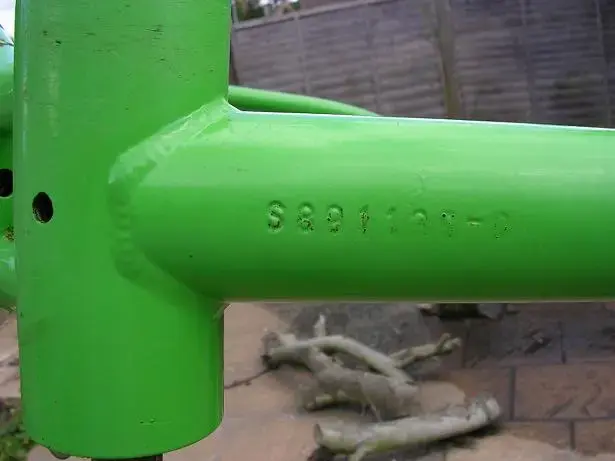

➡️ serial number on the down tube rather than bb shell (S891136-0 or could be -8 )
➡️ 17" c to c seat tube, 21 1/2" TT c to c, 3 1/2" (88mm) head tube
Also, edumacate me on press fit BBs, how do I swap the bearings as these have some movement in and could do with replacing and where do I get bearings from?

looks like a GF to me to, 1 1/4 headset and press in BB- the rear stays are reminiscent of my old GF Prometheus so my guess would be 1990/91
I got replacement bearings from a chap called willie bain http://www.bicyclerepair.co.uk/
but they lasted a winter so one of those BB that self tighten would work better, yst rings a bell or the mavic one (see the dale thread below) would be even better as they are very good quality
looks quite cool 8)
was going ot say the same, i had, now LGF has my one, had pressed in bb bearings and 1 1/4" headset.
btw i had a load of sealed bearings if you want them (assuming they are the same)
to get them out, i just tapped the bb axle (after taking out the circlips), and they came out really easy, you can revirse for one of the bearings, but can used a bit of plastic pipe etc, to push in the last bearing
look forward to seeing that one turn up at my place soon :wink:
Do they do them in an 88mm shell width?
