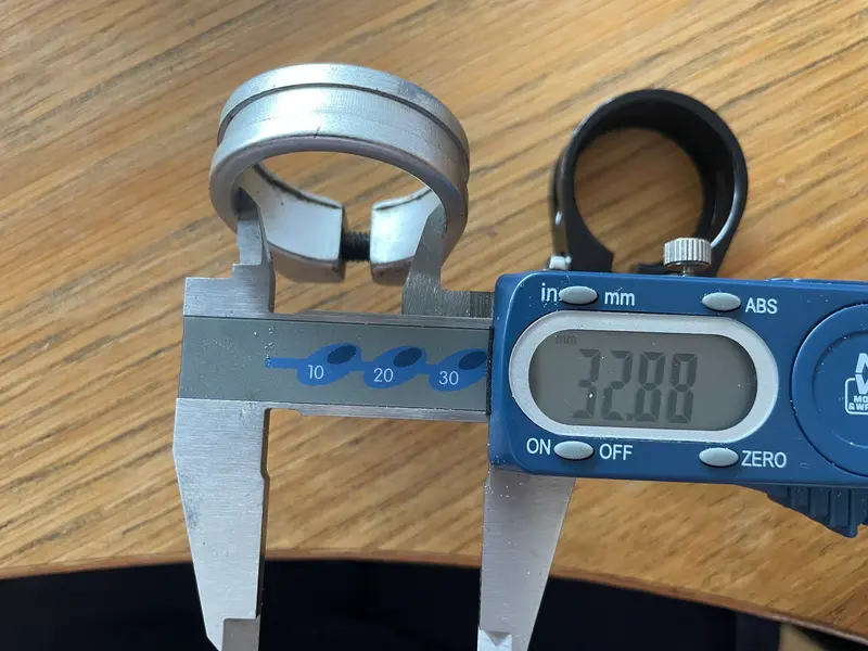

The old clamp measures about 32.88

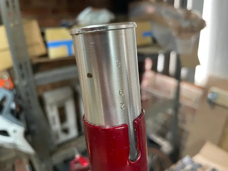

The seat tube ID (as confirmed by the shim) is 29.6 (to a 27.2 post)

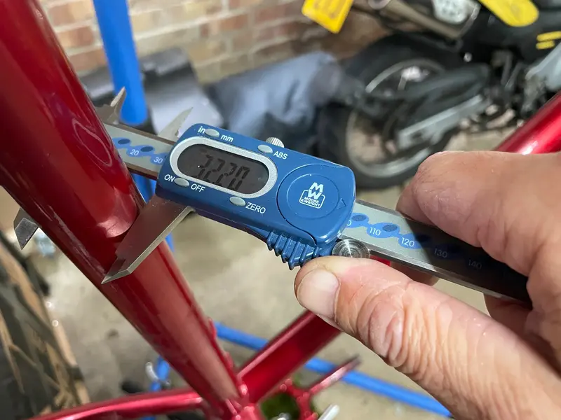

The seat tube OD further down is a fairly consistent 32.2
>> OD seems to be consistently bigger than factory spec, just by a smidge.

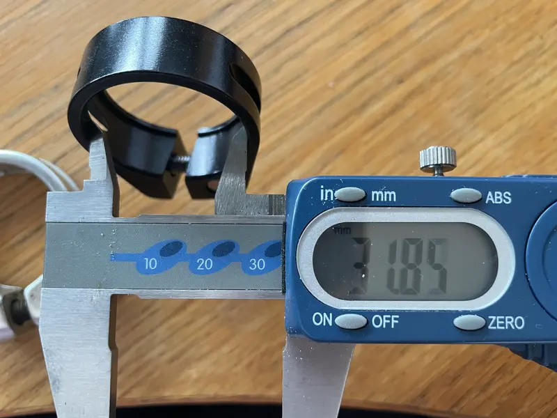

So, yeah, tried the 31.8. Nope. Mainly as my seat tube OD is 1mm wider than 31.8 to start with.
