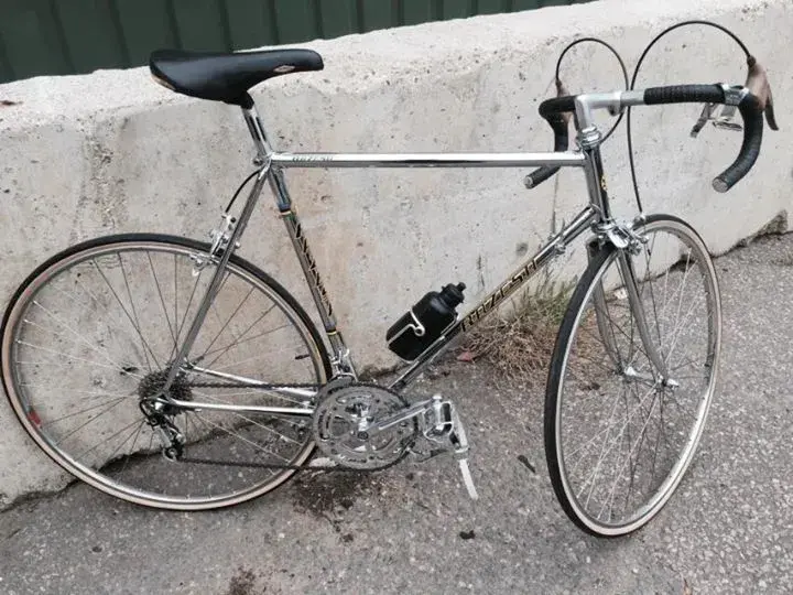

Fun Frame Game :) like it. With good old old google I looked at who used RGF bb shells around Merseyside.
Everyone did at the time but Harry Quinn popped up on Classic Rendezvous and has serial numbers and not all were stamped with a OI to make a Q. Some 3000, 4000 and 5000 numbers showing on there 5000s being 80s. Pure guestimation but a possibility. Some frames showing no Q were made to order it also shows.
What colours were on your frame? Original colour could help identify if it is a Quinn?
Like Shaun says anyone could have made it and someone else puts a serial number, paint and transfers on it. I actually saw a full Chrome Razesa yesterday with the same lugs and campag drop outs as yours. Stunning!

I have a Langsett frame which has similar lugs, seat stay/seat, brake bridge. Frame was purchased new in 1988. I believe at that time Langsett (Sheffield) did not build their own frames. Someone out there may know who did.
Been checking Ellis Briggs frames out Steve and give them a try. If you have Facebook they're on there or drop them an email. Worth a shot, they used four numbers on their frames.
Simon
Interestingly if you do a web search and put in the words (RGF stamped on bike frame) there is quite a bit of stuff that turns up on it looks like it may be french or at least the BB could be tho don't quote me on that tho.
