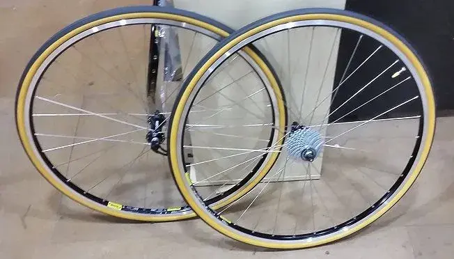

So, two days ago I turned up at Enigma with a bunch of parts, hoping that I'd manage to get bits that fitted my new frame OK and also hoping I hadn't forgot anything. I had arranged with Enigma that I would get some help building the bike, largely because I wanted to get it right and I wasn't sure on how to do some of the bits (bottom bracket being one of the things) but also I wanted to find out how they managed to bolt together some very nice bikes.
I was firstly pointed at the wheel building jig where I placed my lovely round wheels that I'd laced a few days earlier. Except, well, they were not that round really. This was the first time I'd used an actual jig and it had dial gauges on it and everything. Thus I had a bit of time to try and sort out getting the wheels actually round and try not to inflict too much strain on the springs. actually after a while, they did become quite round. All that said, I had a whole bike to build and the wheels were round and I then put the tyres on :)

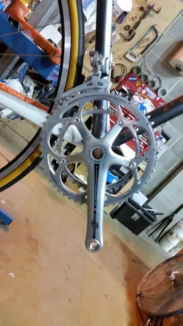

Next up, I got a bit of help and asisstance fitting the Campagnolo BB as it wasn't one I'd done before. We also had to make a little adjustment for clearance of the chainset on the frame which made for an interesting 1/2 hour. The paint on the bike was also looking really well done (whether you like the colour or not the job is really good) so I had to remove a little bit of paint at points to fit a few parts and not snag up a load of paint behind things.

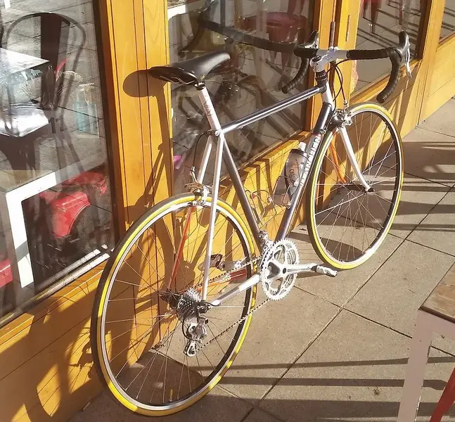

On Saturday I could have sworn that the new bike was looking at me funny in a sort of 'Are we going biking then or what' kind of way. So after 2 weeks of just the short commute to work, I put on the bike clothes and ventured outside with my new bike. This was actually the first time that I'd seen the bike in daylight / sunlight and, rather biasedly, I thought it looked really good.
I was a little sceptical as to how I would feel riding my own bike, but I couldn't help smirk as I clipped into my pedal and pushed off down the road.
So without waiting a moment, I went straight for coffee, covering a whole .75 miles in doing so. After that, it was actually time to do some biking and therefore I set of on a 15 mile loop near to home in case there were any gremlins or problems. This was a bit cautious as actually from the off and no doubt due to the assistance I got at Enigma, there really wasn't any problems at all. 15 miles done and I figured that was a good start, more coffee and a quick photo and we're done for the day.
Ride 2 was the following day, which was not quite as sunny and had more dampness attached. I even got the bike muddy and managed a minor scratch for good luck! So largely, I have put it away for a few days until things improve with the weather.
The bike rides nicely and that's probably no small part in due to a comination of Enigma, Geoff Roberts, Bike Cad and so on and of course a lot of iterations of the history of the bike. However, I quite liked it but as the weather was a bit inclement, I was a bit cautious and still had in my mind the thought of the the bloke stood there, tongue poking out of mouth, welding it (me). Therefore it'll take a few more hills and corners to understand if it handles well and climbs nicely.
So that's it, I noted its not yet snapped, its still in one piece, it got coated in mud, scratched. It is therefore officially one of my bikes :)
