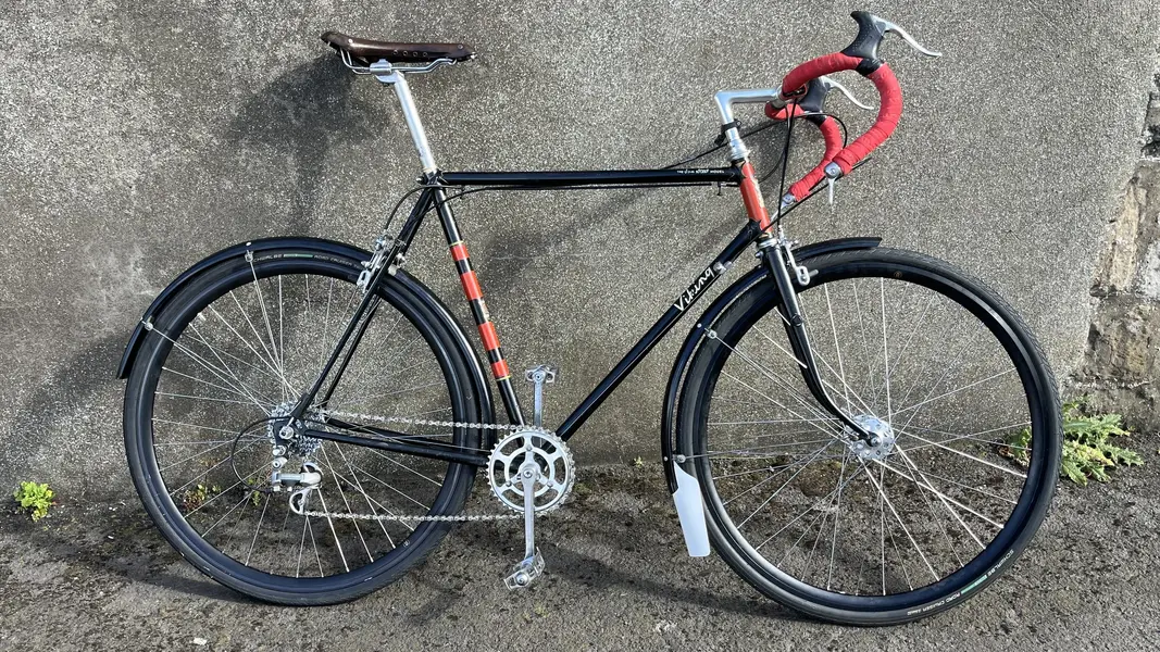

Another 1950’s adventure (Viking Ian Steel Model)

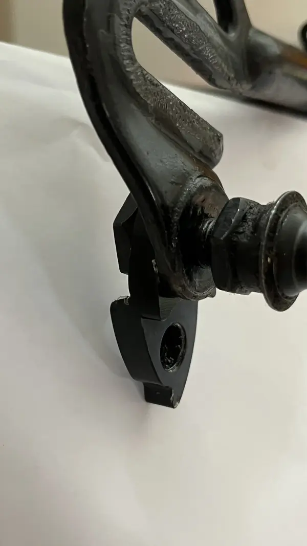

Can’t remember which one this is - got it a couple of years ago for a “project’. Must have decided to resolve it differently!

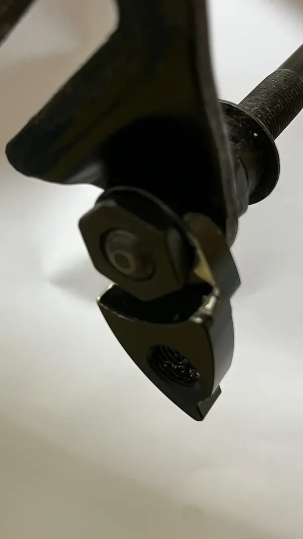

Reason for domed nut is ‘cos it looks ‘interesting’ but also to hold hanger on short section of axle because Cyclo dropout isn’t metric.
Process here -

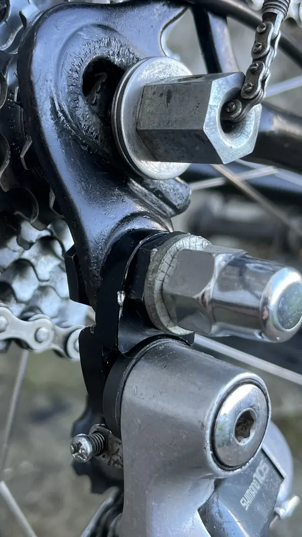

Gears work well - one advantage of 3x7 is single chainring and less concern about mech capacity.
Hanger extension means allows use of short cage mechs. Can also have larger bottom gear sprockets than ‘normal’ for mech.
Added extra lock nut at back before cutting axle
