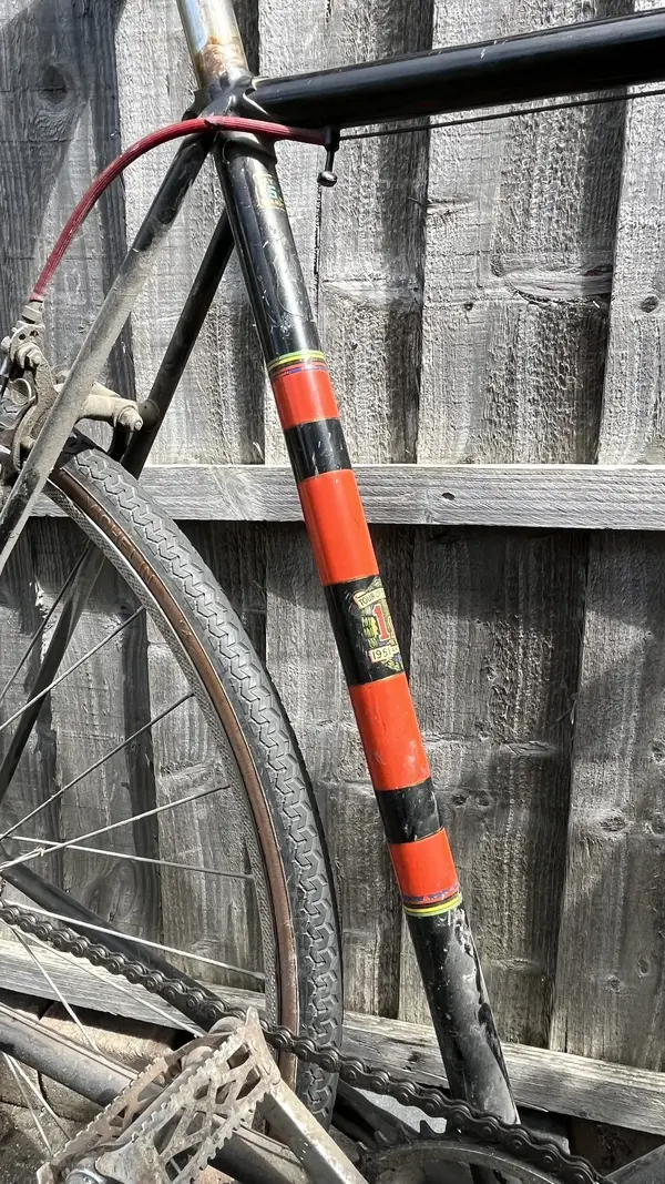

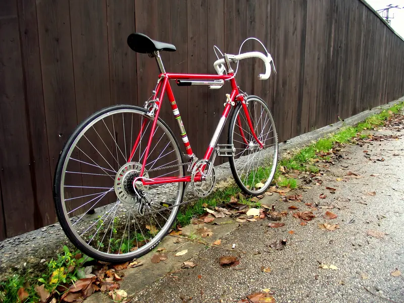

A friend found this on Gumtree and imagined it would be his size.
Fortunately not…
The forks are obviously not original but no apparent crash damage to the frame.
Clearly a classy machine, well worth spending some time on
The wheels weren’t original, and steel. so no dilemma about replacing.
The brakes were ‘cheap side-pulls’ so I thought about replacing with GB or Mafac centre-pulls.
Except that it turns out ‘50’s 730s had a whole different quality to the ones I remember from the 80’s - less sloppy and also chromed brass nuts rather than more easily damaged aluminium ones.
Gears, well only 5 and I’m not nostalgic about Benelux rear mechs (though I did like the P2 - bought one when they first came out).
As the frame only has one gear lever boss, i decided to go for Sachs 3x7 gearing with Campag barends.

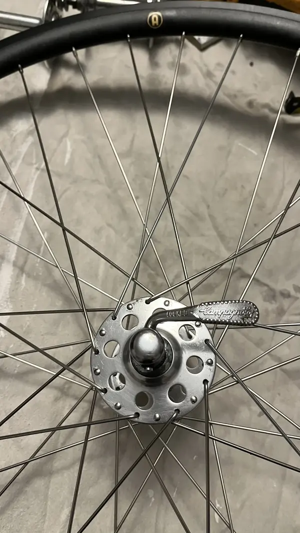

Front wheel on temporary loan from a Hetchins until I build a match for the rear.
Bluemells Club Specials to be fitted shortly.
The original GB bars are too narrow for me. These came on another bike complete with (almost matching) bar tape!

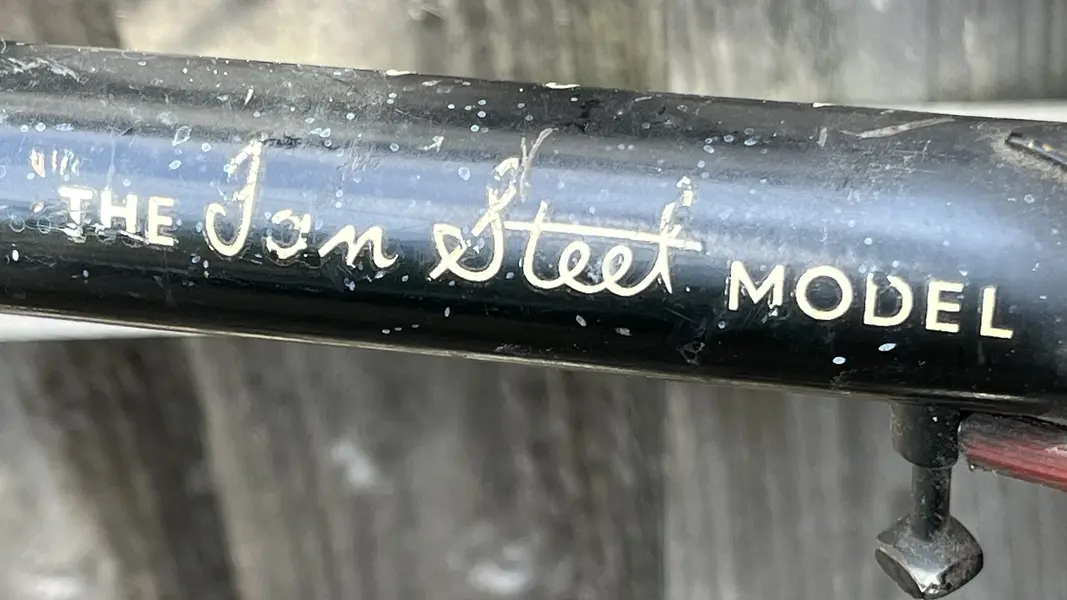

This “Model” is 1957 - AX on the Williams chainset.
Viking offered several variations of spec on each model, and sold framesets, so it’s impossible to be sure about ‘original’.
I replaced the 48T with a 40.
Saddle is original Mansfield Ace. Comfortable but squeaky.
Really nice ride.
It will be my holiday transport in two weeks. (Leisurely 40 miles a day max.)

lug pattern NERVEX 45/159

Weinmann 730 brake manufactured in this manner up through 1963;
change to later design with recesses in face of caliper arms took place during 1964
big jump in performance easily achieved with fitment of Koolstop or Mathauser pads
“big jump in performance easily achieved with fitment of Koolstop or Mathauser pads”
Yeah, v wise
Like Koolstops not sure I’ve ever had Mathausers.
Not sure about headset.
No obvious marks
Wondered about TDC, maybe incomplete?
BB Brampton. Don’t know if axle original as chainring too close to chainstays - noticeable damage
Replaced with 3mm wider TDC

Note cable guide/pump peg
Viking design?

have your researches revealed what the missing/faded transfer on the seat tube below the tubing transfer would have looked like?

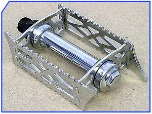

pedals appear to be Phillips Apollo, these enjoyed quite a long production life with some small changes through the years
