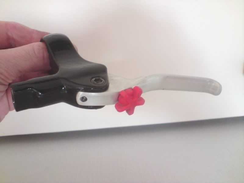

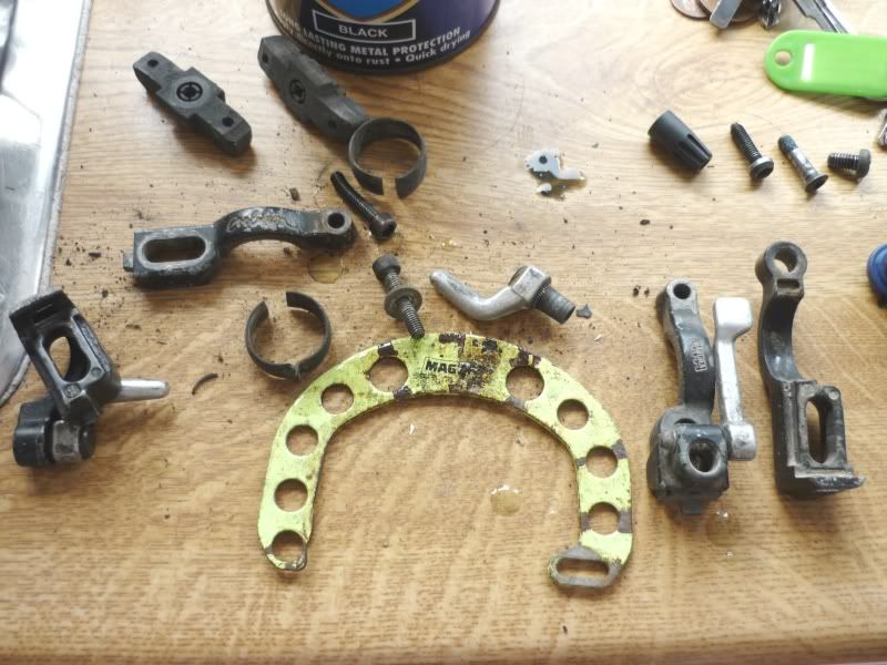

Next up was the rear brake, which I chose a Magura Race-Line. I bought some a while ago that needed a full strip and rebuild. I have detailed the pictures below, but it wasn't easy, as the adjuster knobs had stripped their thread inside the lever, and Magura never made replacements. Xesh is supplying me a spare two for my other levers, but I managed to salvage one for this build. Thank you Xesh.
From this pile to this...
Ti bolts used where applicable, and I'm waiting for a Carbon booster.
The levers were anodised Black and I wanted them to match the Hope levers on the other side. I used oven cleaner to strip the anodising and then wet'n'dry'd them using sandpaper to get the same look as the Hope. When I was happy, I carefully coated them with clear varnish to maintain and protect them.

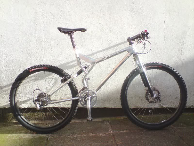

So, as it stands in mock build form...

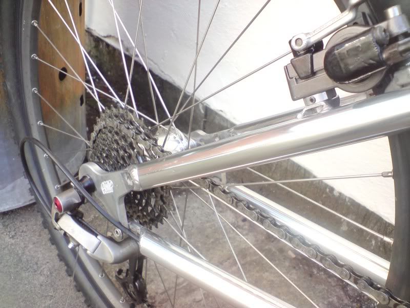

I've made a few changes to the B4 over the last few weeks. I restored its original (and expensive) Gore cables, and swapped the seat stay for a longer and more laid back one. Fettled the gears and then pumped the risse rear shock up to 180psi and took her out for a spin.
It rides really nice across fields and on single track. It doesn't feel like suspension, just 'a little give' over the bumps. I will give it a thorough testing this Sunday, as I only went on local paths with a pocket full of tools to make the on-trail-tweeks.
As with all Amps, they are light and lively. It feels about the same weight as my '95 Marin Team Titanium, which comes in at 22.5lbs.
The disc works well when hot, but not great when cold. I will give it a little longer and if there's no improvement, then I'll get some new pads.
Also discovered some play in the White Industries rear hub, which will need attention. Never opened one of those before!
The full spec is...
1997 Amp Research B4 frame with Risse Genesis air shock.
1997 Pace RC36 forks with alloy steerer
Onza Mongo headset with Ti ahead bolt
Control Tech stem with X-Lite Ti bolts
X-Lite Ti bars
Onza Ules grips
Hope front disc and hub with Pace fork adapter and braided hose
Magura HS33 rear brake with Ti bolts
DT DB spokes with Mavic 217 Ceramic rims (a bit elaborate for the front perhaps)
Control Tech Ti allen key skewers
XTR 9 speed cassette
XTR M950 rear mech with new jockey wheels, Ti bolts and alloy pivot bolt
XTR front mech bottom pull, top swing etc. Looks cleaner anyway!
XT 9 speed shifters
Action Tec Ti bottom bracket
Middleburn RS7 cranks with Race Face and unknown rings
Black alloy chainring bolts and X-Lite alloy crank bolts
Full gore sealed cable set
Thomson Elite post
Flite Alpes saddle
Amp seatpost clamp with Ti bolt
Onza Ti pedals
Onza porc re-issue tyres and Michelin Latex tubes
And of course, my signature...
...a Rohloff chain.
I just want some Red alloy nipples now, and I can replace those heavy ones!

I'm glad you like the bike, but the old X-Lite stem was too long at 135mm, and the seat stay is factory powder coated in Black. The Amp forks would be a nice addition, but I prefer the Pace, plus they are my original forks that I bought back in '97.
Just check out the difference between all 3 versions of the bike, and you'll see how I had to alter its geometry. What looked good, rode awful!
The headtubes are very small on Amps and I needed to raise the bars by over 3cm. The seat now sits about 5cm further back, due to the different seat stay I bought.
I'll let you know how it handles the bigger and rougher stuff this weekend...
