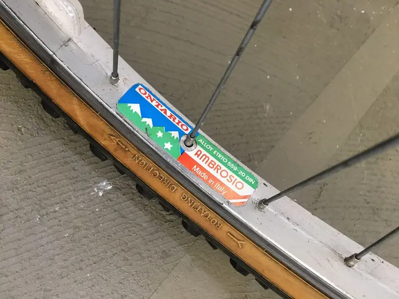

Can anyone tell me anything about these rims? They're on an old Saracen I just picked up. I don't think they were standard. Any good? They're on Exage hubs, prob early 90's? Tried googling it but no results.
Thanks!

Ambrosio rims are most likely to be found on road bikes where they are widely used .
However the mtb rims you have are clearly low end/budget rims best suited to road/
gravel track/towpath use at best
' are they any good ' ? well if they are still usable after 25 years I think you can't complain ,
however they were never very good from the beginning . And by this I mean that they are
not a particularly strong design
Generally speaking in terms of relative strength , rims without eyelets are entry level ,
rims with single eyelets and possibly box section are next, rims with double eyelets and box section are best
The way the rims are ' joined ' is another factor contributing to strength . On your rims the
join is clearly visible indicating a pegged joint . On better rims the join is welded and virtually
invisible
Going back into mtb history , Charlie Kelly notes that 26" alloy rims ( from Ukai/Araya ) first
became available in mid 1979 . He used lighter weight Ambrosio rims in 1980 for a ' century ' race
