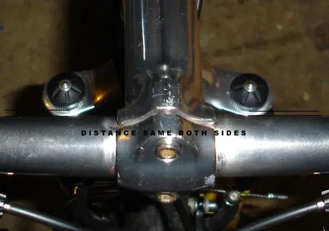

I'll try to explain how I do it, stay with me on this one ...
Stand in front of the bike with the front wheel between you legs. Look from above and line up (by eye) the rear edge of the bars with a point on the top of the forks (adjuster caps or similar). Move the bars until you have equal amount of gap showing either side, the bars are now perpendicular to the front wheel. Not very well explained but it's much easier to demonstrate than explain in writing.
And yes I know the bar is crimped :oops:
