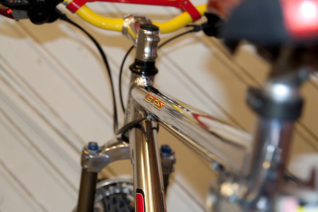

I removed about 7 years of mild corrosion using 0000 and Autoglym on my LTS here..
whhooooaaaa - that's shiny.
