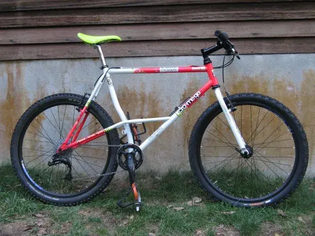

pics please, always like to see an alpinestars
Have posted the beast before, but now it has gears. Certainly not one of the prettier/period correct/high end bikes on here, but I love riding it and it certainly garners some comments.
