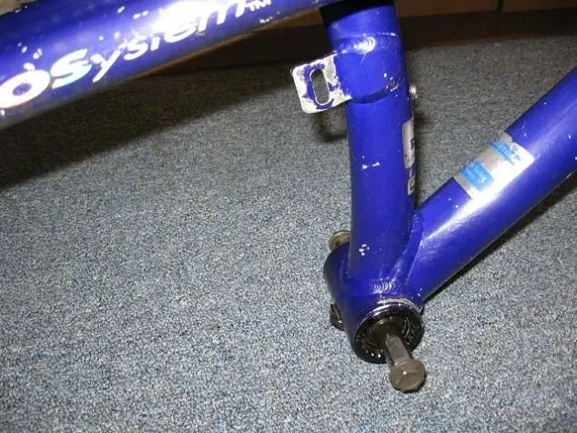

That bare frame is a 92, and it's been subjected to a fair bit of butchering but it could be rescued with a front mech mount welded on. I can give exact measurements if anyone wants to know.
As for the cable guides - the top tube had the rear brake and rear mech in a pair, welded on. The down tube had a front mech cable guide riveted on, so this frame needs them all and you could go for a triple all across the top and use a top pull front mech, maybe using a BB-mounted one? But for authenticity/originality then a bottom pull direct mount/braze on is needed.

I just checked pics of both my 92 Al Megas and they are indeed riveted on, sorry for the misinformation! (91 were welded on the top but riveted on the down tube ;) )
I can't speak for the metallurgy involved, but as a 24/25 year old aluminium frame, it'll be weakened anyway. I can't see how a bit of extra welding by adding a mount for the mech would do much if any harm, but maybe someone better qualified can give a more accurate answer.
