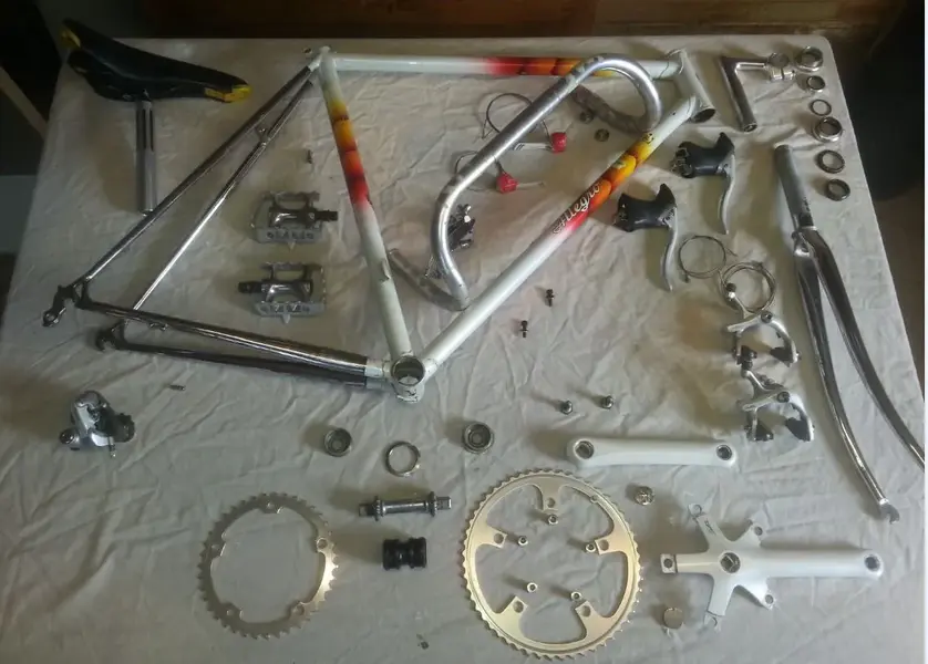

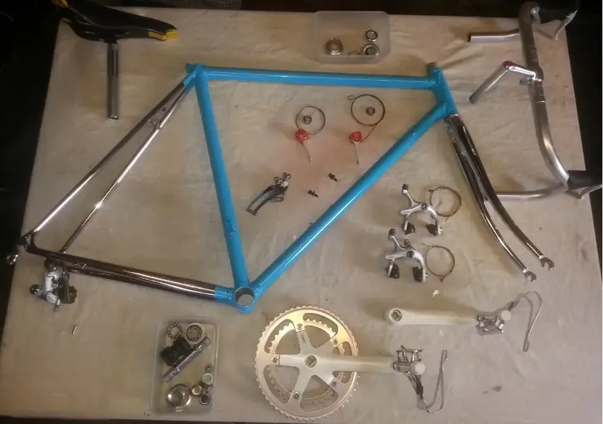

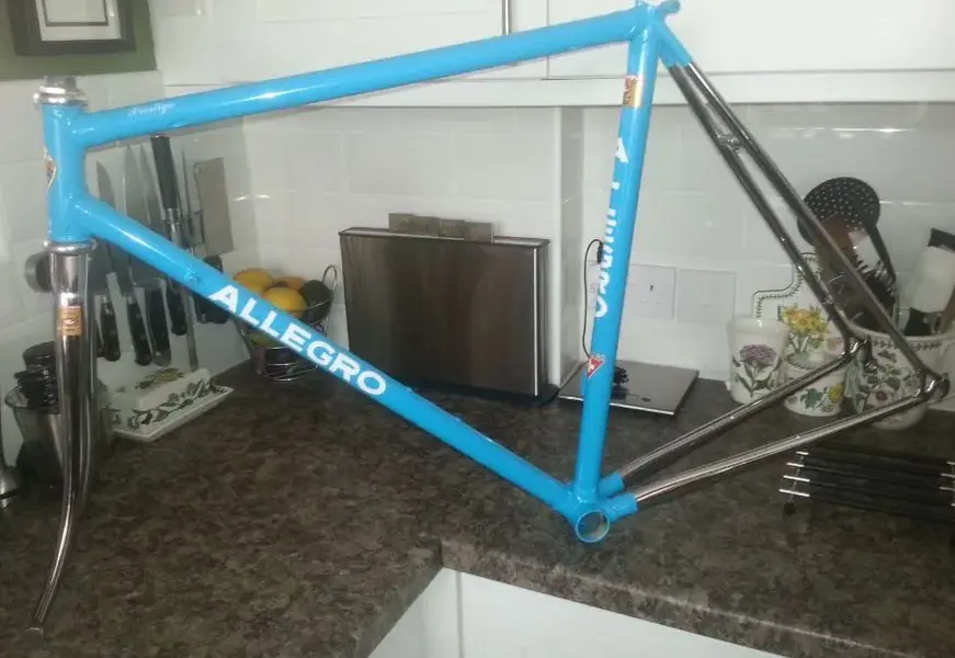

But I plan still to refubish the bike and have taken the frame to the powder coaters for a new finish - colour "Pantone 312C" which is - some might think - is a fairly garish blue, but I like it!
