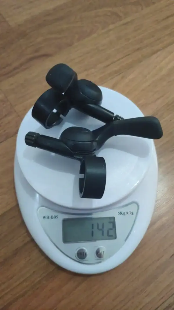

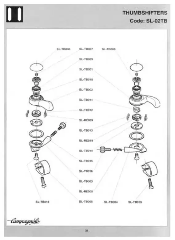

Here you can see in its full glory, weight only 142 gr !! lighter than what I previously expected (157 gr).
I updated my total estimated weight of Alejandro's Adroit Gator 1992 in first page topic
