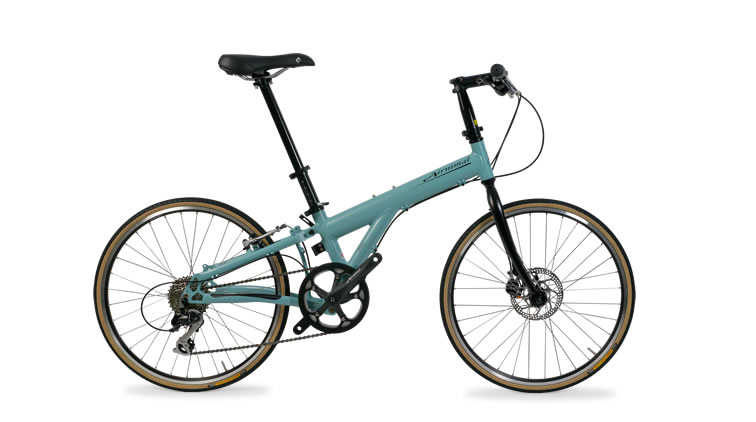

My airnimal Joey pimping is almost complete, but something has been bugging me about the seat tube assembly. It has a normal but long seat post (30.2 so not that easy to come by a nicer post to upgrade, especially in the length needed) which slots inside another tube, creating a telescopic style post arrangement.
What's there is quite heavy and limiting in terms of actual seat post choice, so my idea is to replace the bottom tube with something lighter, possibly titanium. Whilst doing this I'd like to adjust the internal diameter to allow a greater choice of long and light seat posts

and for those like me who are not familiar with the arrangement, there indeed are two seat post clamps.
Not quite. In the pic above (thanks for posting) you see a normal seat tube which fits into another tube. Both are adjusted via a qr, allowing the bike to fold and adult the seat post height. It's the bottom tube I'm looking to replace (in the pic above its the black tube the seat post is inserted into) for weight saving and hopefully allow a greater choice of seat posts. No reaming, pinning or any other engineering is required.

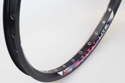

a nice 24 inch, 507 ETRTO wheelset
Have a look at the 24" BMX race cruiser market for rims...Answer do a 24mm wide rim in 28 holes, 440g, though:
https://www.danscomp.com/products-PARTS ... r_Rim.html
Or a Sun Envy Lite, 415g, but 36h only:
Here: http://www.profileeurope.co.uk/product/ ... r-rim/431/
Either could be paired with a super-duper set of MTB race hubs to make a smart set of wheels.
Tyres down to around 26mm wide, too.

Cheers. Ideally after 32H as I have a couple of hub sets already (hope or XT), but I had not come across these in what has been so far a vain search. I hear stans to a 2 inch rim now?
