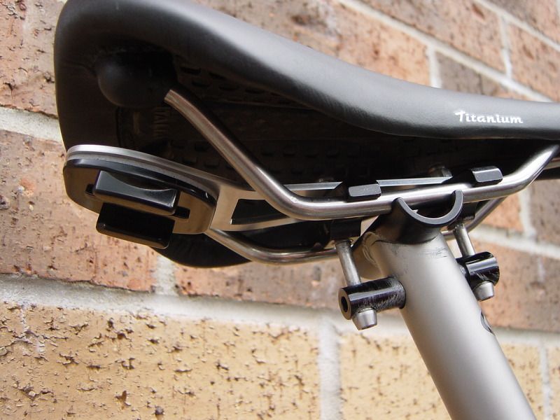

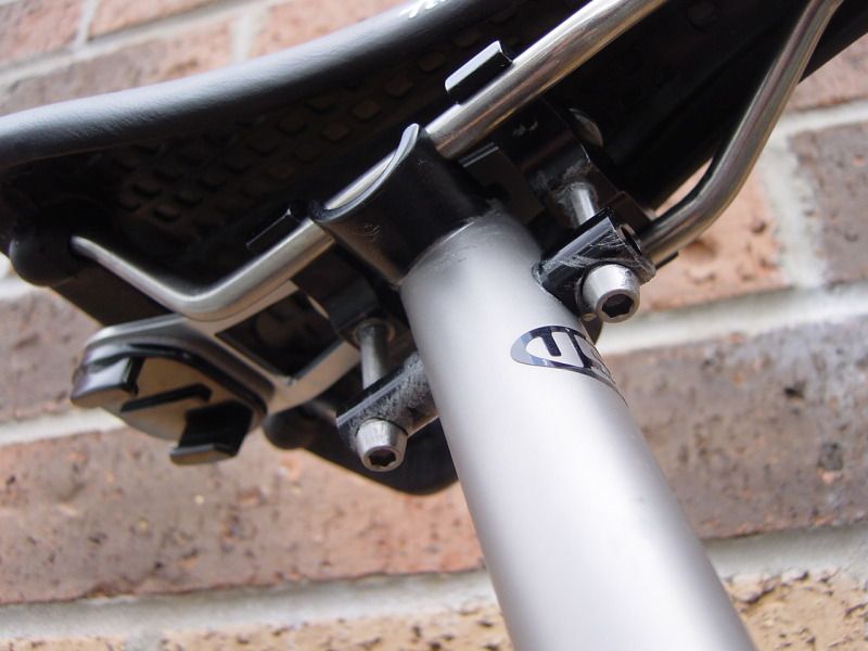

Some more Ti bolts for the Airborne, I couldn’t source the right size :-( so rampage modified the heads and I chopped them down to length :D :
Left to right = Standard Ti / Standard XTR / Modified Ti
WD :D

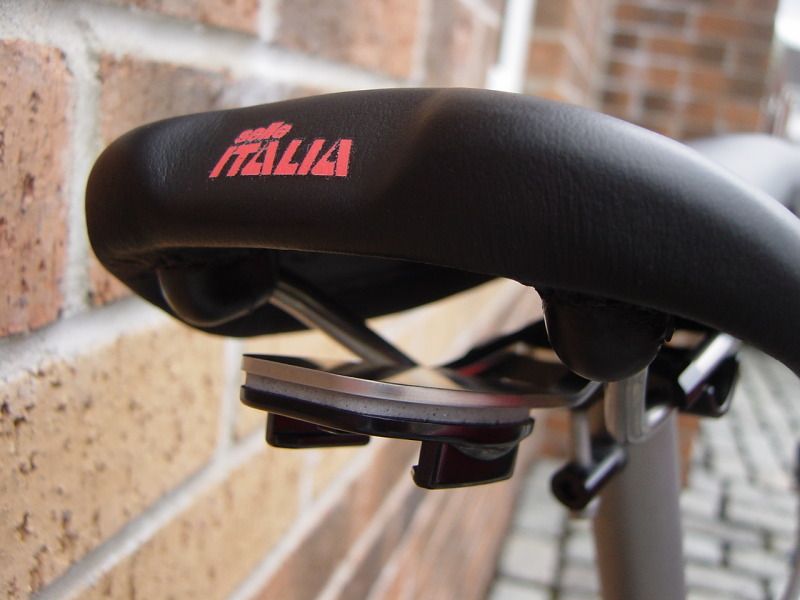

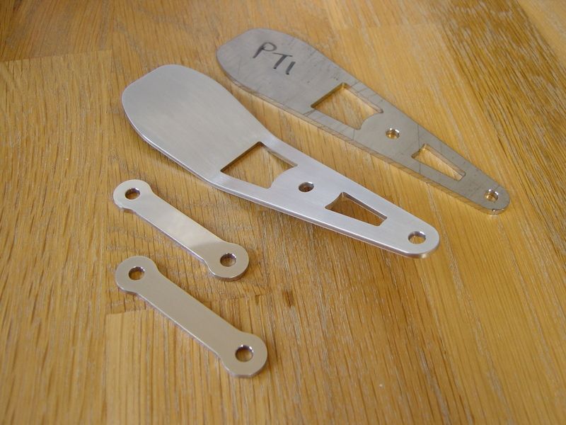

I noted that I could brace the seat assembly more and use it for mounting ‘things’ just by adding longer bolts :D

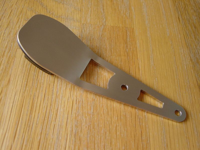

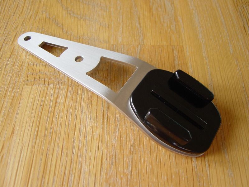

These are stainless plates that I designed and had laser cut (via Rampage) :
I have four of this design of seat post so I had two ‘dog bone’ braces cut and two braces / mounts cut to suit a standard GoPro mount.
I have polished the dog bones and brushed one of the GoPro mounts, the other (non bent) mount is straight off the cutter.
The bolts and flange nuts are titanium, to match the seat posts :cool: :
Ready for mounting under the seat :
This is the seat mount finished and fitted – ignore the assembly paste / anti seize … :LOL:
Just the right amount of kink to retain room to grab the back of the saddle :
WD :D

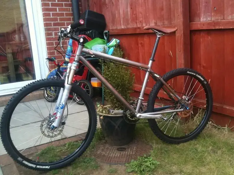

Pics on other threads are old, nothing new gone in my Photobucket account unless it's off my phone ... :-(
I have some paternity leave coming up imminently - that should give me some time to snap some pics in daylight ... ;-)
In the meantime, it rides great ! The only things I have had to tweak are :
• Seat adjustment.
• Stem adjustment.
I still need to set the forks properly and add a bit more stans, the tyres are going down over the period of a few days.
