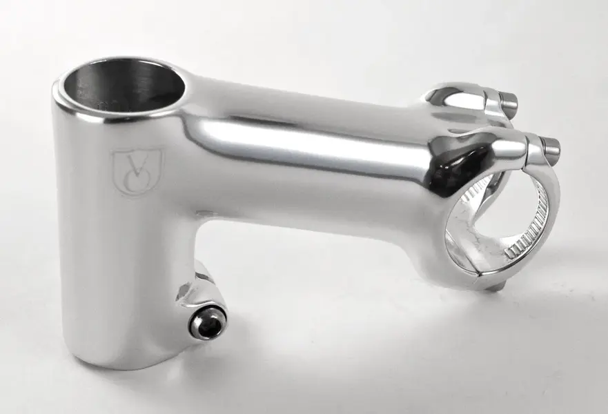

Here's one Aheadset stem I found that's a fairly clean design and gives some wiggle height adjustment even if the steerer is a bit short.
That's pretty neat, actually. My cross bike has the Ahead version of the ITM Eclypse and doesn't look bad at all.
