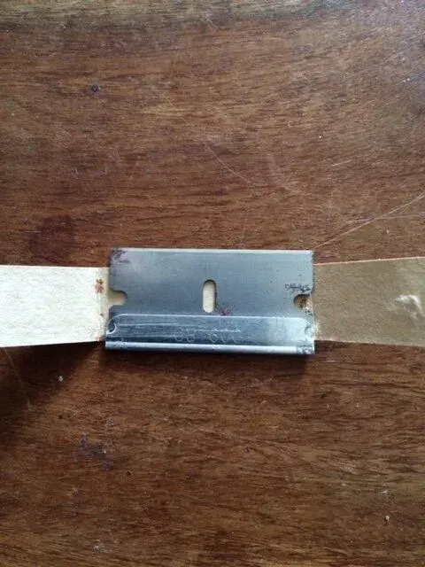

Any clues as to how to scrape off the remaining ceramic ? As ive a pair of cr17's in purple but the ceramic is in such bad state that its missing in large sections.
One rim is cracked and the other looks elliptical :lol: but theyre rare and impossible to replace so im keeping them :oops:
Never tried myself but if it were me I'd try a scraper that takes one of these type blades or maybe a stanley type one though they're a bit thicker.Nice flat edge,less chance of gouging the rim and thin enough to get under the ceramic.Not expensive,available from hardware stores or some motor factors.
