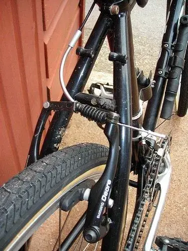

One other question - another poster on here mentioned that he'd "drilled out the lower cable stop so that v-brakes could be used". My bike has Deore v-brakes and v-brake levers, but not sure what is meant my drilling out the cable stop - is this essential for the v-brakes to work correctly, and if so would it apply to a steel cinder cone?

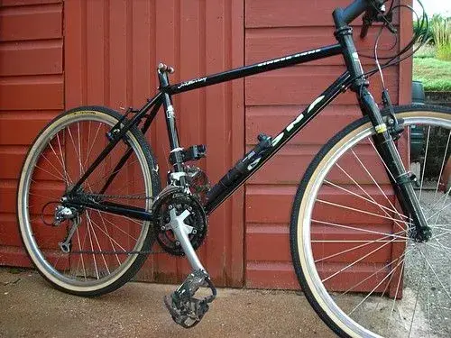

What size bike is it and you got any pictures :D

As for the V-brake, take a picture around the seat collar/brake setup so we can see how it's setup now.
Since there is no cable stop to run the rear noodle to frame cable normally.
hi there, think it is a 19", though if you go on the geometry given in the original 1991 brochure (which I still have), it doesn't correspond to any of the frame sizes quoted...
i've added a couple of pics of rear brake / stem arrangement which i hope will shed some light on what i'm trying to get across - the picture of the cable for the rear v-brake just cuts off the small black ring around the base of the seatpost which the rear brake cable (surrounded by a thin plastic sheath) runs through, and then runs alongside the top-tube before coming up and round to the brake lever.
as you can see from the pic, the cable doesn't sit squarely in the caliper arm, not sure what can be done about this - is it worth re-attaching the arms with the stopper pin in the outer of the three frame locating holes instead of the central hole as it is now?

Might be able to fix that simply by bending the noodle so the bend is a greater angle......I'm assuming your brake cable is going through the seatpost collar rather than bypassing it :D
