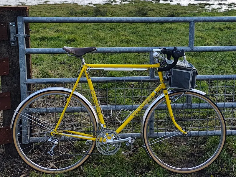

The largest size I ride is 66cm. Not a problem either:

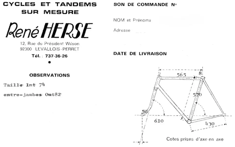

On sizing for a true French fit: this is a frame specified by RenƩ Herse in 1975 for someone with an 82cm inseam.
Centre-to-top frame size would then be 58.5cm, i.e. 71% of the inseam. For me at 89cm that translates to a 63.5 cm frame size and for 87cm that would be 62cm.

The toptube length is the part that can't be altered - on this RH frame, it's tall for the length - it's 56.5, same length as a modern 56 to 57cm frame - or a 22 1/2" in imperial money.
