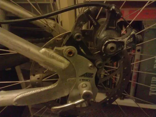

M MuPpEt Retro Newbie Aug 20, 2012 #1 any one got any advice on fitting a rear disc calliper on my 1995 GT TEMPEST or any pics of other bike that have had this conversion done. any advice would be much appreciated thanks
sic_nick Senior Retro Guru Feedback View Aug 21, 2012 #2 I fitted a rear disc to the other halves GT Arrowhead using the A2Z adapter quite successfully.
sic_nick Senior Retro Guru Feedback View Aug 21, 2012 #3 If the rear dropouts are the flat plate type it will work like this: Attachments disc adapted GT.webp 20.9 KB · Views: 215
