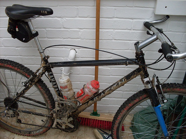

Hi there Phil. Firstly, the Sahara that you've got isn't quite a non-sus frame -- it's just that the forks that it was designed for are very short-travel. But I know what you're going thru... ;)
Even though I had these Bomber Z2s available, I was worried that with 50 or 60mm of travel, they would be too long for the Sahara (axle-to-crown distance was an extra 10 or 20mm compared with the forks fitted by Saracen). So I bought a pair of RS Quadra 21s from another RetroBike member. The threaded steerer was exactly the same length as that on the original Saracen forks so it was an easy swap. And because they were very short travel, they suited the geometry of the bike perfectly....
(Excuse the strange routing of the rear-brake cable, that was my first attempt at connecting V-brakes to a frame that was designed for cantilevers. I eventually sorted it out, as seen on another thread.)
However, tearing along stony trails with only 15 or 20mm of travel in your front forks soon takes its toll on your wrists. And so I ditched the Quadras, had an Aheadset fitted to the bike and popped the Bomber Z2s on.
What a difference in ride quality! The look of the bike is affected by the longer forks -- but you really don't care because the Marzocchis are SO much better than any shorter travel forks that you could fit.

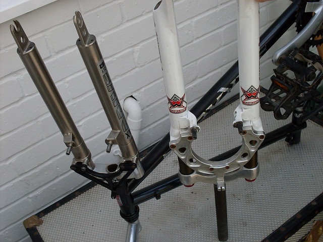

Thanks for that.
The Marzochis I've got haven't got a name on, so I can't tell you exactly which they are.
THere's a pic here off Google of some similar:
'cept mine have about 2" of travel - much shorter than these. The fork's are the same though, in that the chamber only goes half way and then tapers to the end. Oh, and mine are red, if that means anything. They have two little dials on the front to adjust the dampening. The only thing that makes me wary of them is whether they are dependable. Don't suppose you know how they work. I'm guessing chambers with air seals.
Are those seals likely to perish with age?
I quite like the idea of using them, as I'll just be touring, so not bombing it anywhere, but they should give some relief from rougher terrain.

here's some photos, front and back:
Looks like a lot less travel to me than those DH3's[/img]
The early elastomers did perish, age was one thing, contaminaton with oils was another, later MCU's came out which were more resistant, but have heard about MCU's liquifying with heat and there dripping out the bottom. My fors I am still experimenting with, and have managed to pull the rebound elastomers out of an old HiTen fork, which used steel springs and elastomers. If this current idea doesn't work out, I will have a go at casting my own out of a two part polyurethane casting kit which gives a durometer shore rating of A50, which I understand, is ok for shock forks ;
