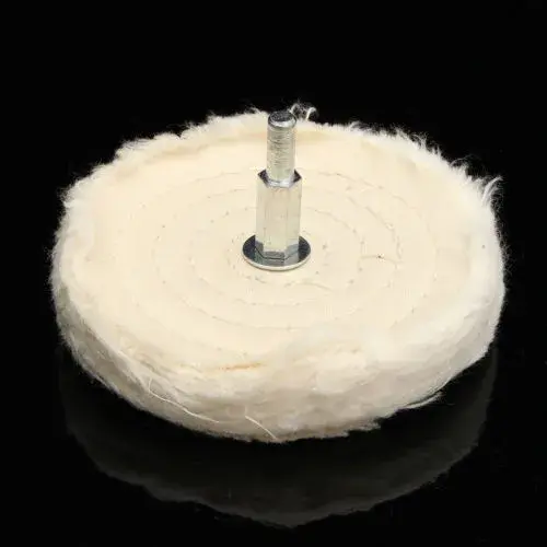

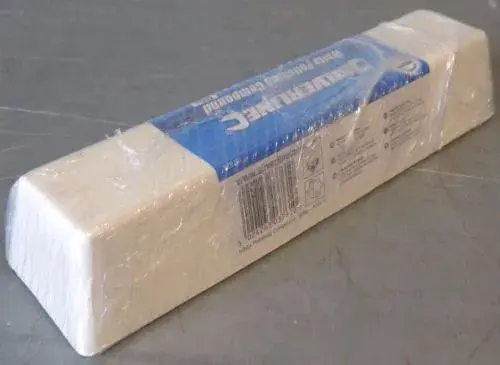

I start out with a polishing kit consisting of a large diameter polishing pad and a bar of polishing compound.
Put the pad on a drill, run it while holding it against the bar so that the polishing compound gets all over the side of the pad, then use it on the frame.
If it doesn't do anything, there's still laquer on the frame. If the frame starts to mirror somewhat, it's bare and you can go to work with steel wool to get rid of the corrosion before properly polishing it.

Wet and dry paper to start with, used wet, I've found 250 grade to work on the deeper scratches, then 300 all over and finish with 400. Then finish with a rotary polisher in a drill as shown. Autosol is the best I've found for aluminium, but as other mentioned bras so also works.

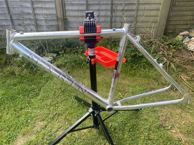

I have recently acquired a '93 Marin Rocky Ridge for doing up. It has a 7005 Aluminium frame but is mottled to hell with oxidation pretty much all over. In places you can see it's original shiny finish and I'd like to get back to that if possible. Any ideas how?
I used a bit of fine wet&dry on a test patch but as well as sanding off the spotting it left the frame generally 'matte' with silvery powder everywhere so I stopped in case I was causing any damage. Is this normal prior to further treatment or have I ruined it?
Any tips on how to restore to its original shine gratefully appreciated! Cheers.

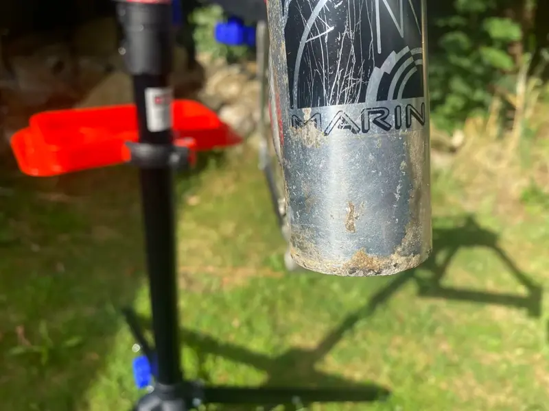

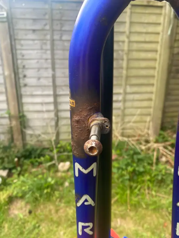

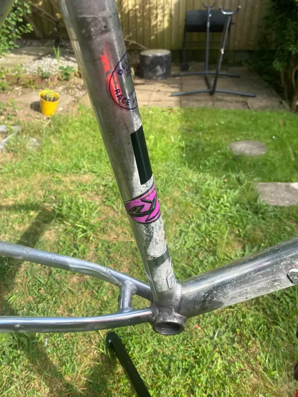

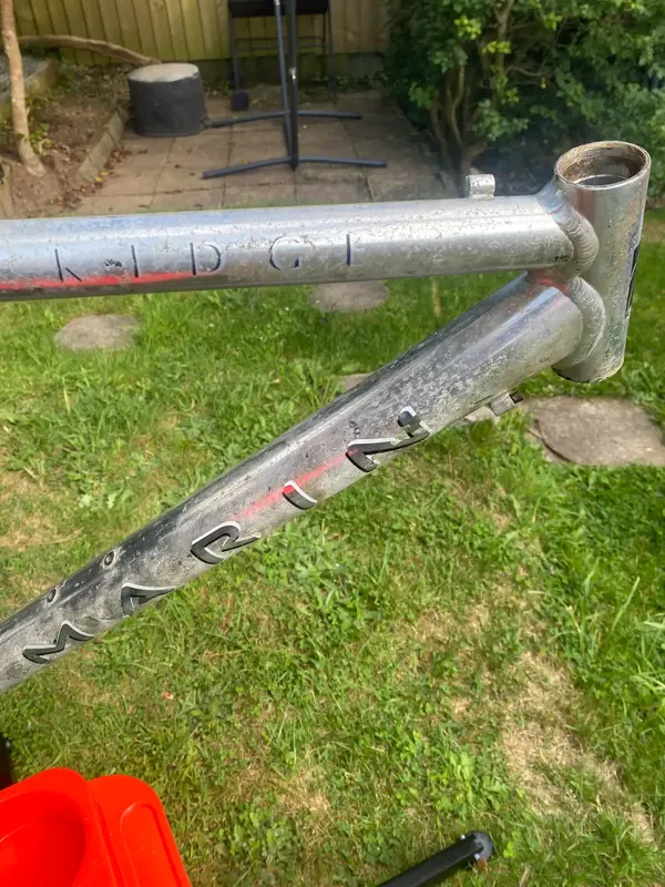

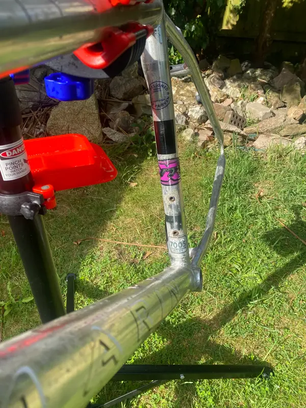

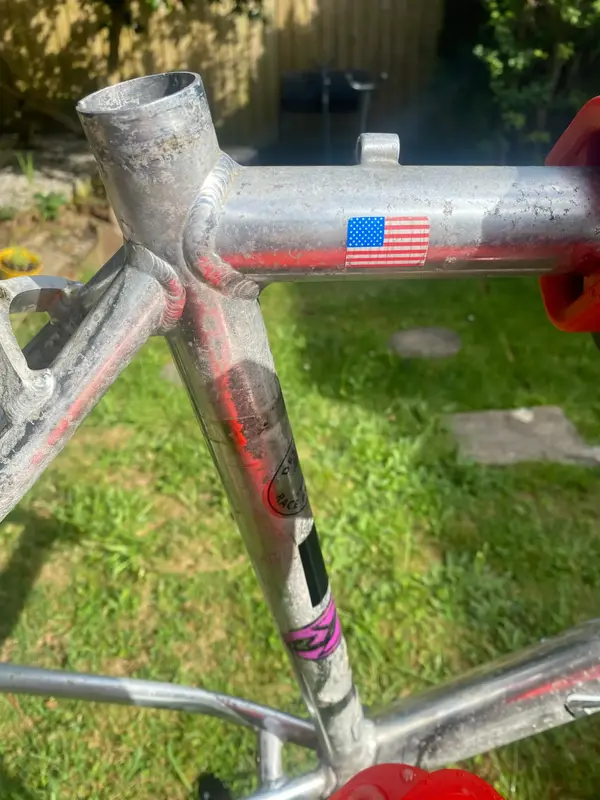

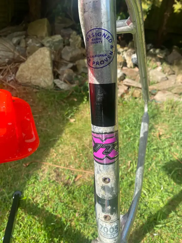

Hi how did you get on with this mate as I am in the same boat with a 94 Marin rocky ridge did you get the finish you were after ? Thanks

That was a bit like my Indian fire trail and it's the hardest one to get the clear coat off alright I only done 3 frames but for some reason weather Marin used a different clear coat to say orange I would definitely use a power tool yours might be different I hope so mate
